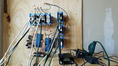

Step 2: Building the 125v Circuitry
The first step is to build your circuitry in preparation of the show. DO NOT OVER STRIP YOUR WIRES, YOU DO NOT WANT EXPOSED WIRE THAT COULD DELIVER A SHOCK!
  1. I connected both 8 channel relay boards to my scrap piece of plywood. I flipped the second board upside down so that the pins used to connect the Raspberry PI on both boards faced the gap between the 2 boards and were about 6 inches apart.
  2. Wire the positive (power) bus around the relays. Make sure you are using wire that is capable of handling the 125v load coming from the house like what I listed in the supplies step. There are 3 screws for each relay module. The bus for the incoming power will go into the center screw on each relay. Use the In-Sure connectors (or wire nuts) to bridge the incoming power into the center screw of each relay on both boards.
  3. Mount both of your plug housings to your board. I just used screws through the inside of the housing into the plywood.
  4. On all 8 electrical outlets there will be 5 screws. 1 green which is for the ground. 2 Silver which are for your neutral and 2 gold which are for your positive (power). By default you will only need to use the ground screw, 1 neutral and 1 positive. Between the gold screws there will be a metal bridge sticking up that connects the top screw to the bottom screw meaning if you power 1 screw, both outlets become active. We don't want this. Break the bridge cleanly off to ensure the top and bottom screws are now completely separated.
  5. Pay Attention to how you wire this step and ensure you know which outlet corresponds to each relay. I marked mine with masking tape and a pen over the outlet face. Run a wire (capable of handling 125v) from each of the common out screws on the relay (it's the screw where the top line doesn't connect to anything) through your electrical outlet housing and into one of the gold screws on your outlets. After running each of the 16 common outs to their corresponding gold screw go to the next step.
  6. Create a neutral bus. Using the In-Sure connectors (or wire nuts) run a wire (capable of 125v) through each electrical outlet housing and to 1 of the silver screws on your outlet. The wire from each silver screw will be bridged together into 1 long wire. Since we did not take the metal bridge off of the silver screws we only need to run a wire to 1 silver screw on each outlet instead of both.
  7. Just like with the neutral bus we will use 125v capable wire to run a wire to each of the ground screws. Run your wire through your housing and to the green (ground) screw on the outlet. Just like before these will all be bridged together into 1 long chain.
  8. Mount your outlets securely to the housing using the provided screws and then cover them with the faceplates.
  9. Hooking the circuit to power. I used a plug similar to what I put in the supplies that allows me to run my own wires into the plug and screw them in place. I used the In-Sure connectors to wire mine so I ran a wire off an open port from each bridge into the corresponding screw of my plug. You will need 1 wire off the power bridge from step 2, 1 from the neutral bridge in step 6 and 1 from the ground bridge in step 7.
Once this is all hooked up you will have completed the wiring for the 125v section of this tutorial. See how to wire the relays to receive power and data from the Raspberry PI next!
Step 3: Building the Raspberry PI Circuit
Now we will build a second electrical circuit to actually flip the relays on and off using the Raspberry PI.
  1. I powered my relays using both the 5v pin on the Pi as well as an external power source. For my external power sources I found old USB based phone chargers. Each individual relay requires up to 30 milliamps to flip. This means each board needs 240 milliamps to flip all relays at once. The relays I bought (please check your board's specs as they can change with each board revision) support up to 2 amps. The power supply you choose needs to have 5v output with less than 2 amps output. The chargers I found were 5v and 800 milliamp output.
  2. Cut the connector off your charger where it would plug into the phone. If you used USB charging like I did you will see 4 wires when you strip the outside protective casing back a bit. The wires TYPICALLY are as follows:
    A. Red - Positive (power)
    B. Black - Ground
    C. White - USB Data +
    D. Green - USB Data -
  3. Cut 1 end off of 2 jumper wires. Strip the cut off end to expose the bare wire (about an inch long). I used a red and a black wire to match what is inside of the USB cable.
  4. Strip the Red and Black wires of the USB exposing the bare wire (about an inch long)
  5. Twist the wire from the red jumper wire to the red wire of the usb and cover the joint in electrical tape.
  6. Twist the wire from the black jumper wire to the black wire of the usb and cover the joint in electrical tape.
  7. Repeat steps 2 - 6 for the second charger.
  8. On the relay there will be 3 pins with a blue jumper on them. The 2 end pins are Ground (GND) and JD-VCC. Remove this jumper. Do this for both Relay boards.
  9. For each relay board plug the red jumper wire from 1 of your chargers onto the JD-VCC pin and the black wire to the Ground pin.
  10. Next we will begin connecting the Raspberry Pi to the relays. There are 2 5v GPIO pins on your Pi. Run a cable to each relay from a 5v pin. It will plug into the 5v (may say vcc) pin on the relay. NOTE: This is a seperate pin than talked about in steps 8 and 9. Here is a GPIO layout for the B+ http://www.raspberrypi-spy.co.uk/wp-content/upload...
  11. Now run 16 jumpers from your other GPIO outputs to the 16 pins of the relays (8 each board). Note: At the end of the pins there is a ground pin that we will NOT put a wire to. This prevents a completed circuit and makes the Raspberry PI isolated from the additional current provided by the external power supply.
  12. Connect the audio cable from your FM transmitter into the audio out jack on the Pi.
