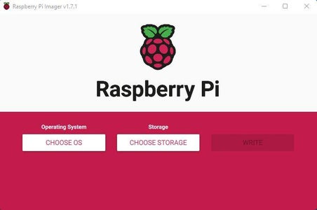

I'm going to use the Raspberry PI Imager . It's an excellent software and allows not only to install Raspberry PI OS, but other img files as well.
Just execute the imager.

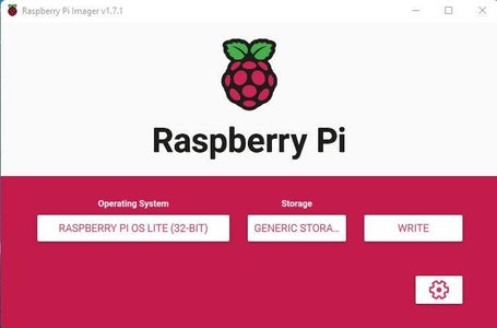

Choose the operating system. We just need the Raspberry PI OS 32bit Lite version. No GUI is necessary.
Next, choose the storage.
In this news version, we can - supposedly - customize some things in the image before we write it. I've tried, and it didn't work.
After choosing the storage, just write it.

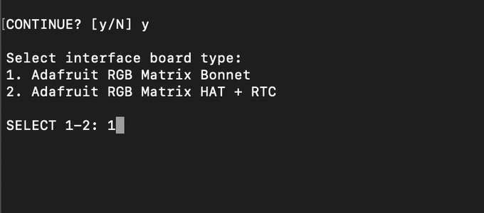

This script will configure some options for the bonnet.
The first decision to make is to choose the Bonnet type. We choose option 1.

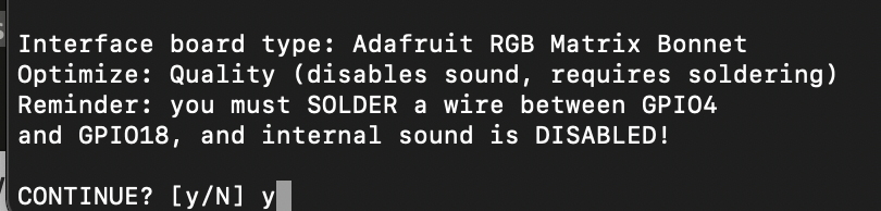

Next, quality versus Convenience. We don't need sound, so we choose option 1- Quality
Finally, we're displayed the chosen options before we continue with the install.

Because I've chosen quality, I need to bridge together GPIO 18 with GPIO 4 of the RGB Matrix Bonnet. After that, everything is pretty much done.

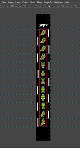

Since we want 12 frames, we create an image that will be 32 pixels in width and 384 (12*32) pixels height .
Next, by using Gimp guides, we put an horizontal guide every 32 pixels. That will be the limits of each frame. If you look closely, in the bottom of the gimp image, the pixels are displayed. You know always where you at.
After you have put guides in the image, you need to open the sprite sheet and copy each sprite individualy to each "frame" of the image.
When pasting in Gimp, it will be a new layer. If the layer is bigger than 32x32 (size of each frame square), you need to resize it.
Always resize the layer uniformly (the same amont for both x and y at the same time). Do it until all the sizes are bellow 32 pixels - widht or height, both need to be bellow 32 pixels, but they don't need to be the same, or the image will be askew and look weird.
Always try to center the image in the square, but make sure none leaves the margins.
Do that until you have all the frames you want.
As you can see, the image with all the frames and the guides is not centered, because that frame has a bigger height than width.
After you finish, just save the image. Always as a BMP.

Next, another loop - the animation repeats and it's here that we're going to display the frames.
We've load an image that's 32pixels width, but more in the heights. In the beginning, when loading the image, we stored the width and height.
The image that we've loaded contains all the frames. What we're going to do is to crop each "frame". When building the image, we set "boxes" of 32x32 pixels. So, at every 32 pixels height, we have a frame.
In a for loop, for a range from 0 to height of the image - with 32 pixels each steps, we crop the image for the current frame. Cropping does not changes the original image - it just stores in cur_sprite that cropped part.
cur_sprite = image.crop((0,sprite_y, 32, (sprite_y + 32)))
The crop function accepts 4 coordinates - top left x and y and bottom right x and y
