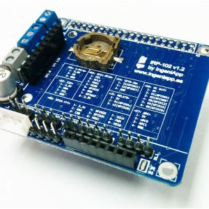

  • (Optional) IRP-102 HAT Board. This board makes us easy the work of connection all devices for this project, and also allows us to have a RTC clock.

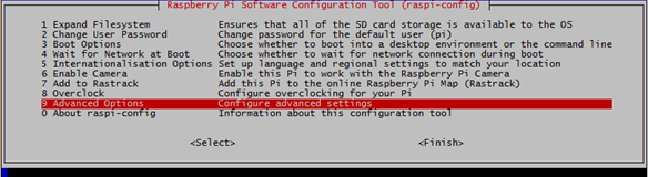

1. Enable I2C
We have to check that I2C bus is enabled to be used by sensors. If not, we must to switch it on. Run the de configuration assistant this way.
sudo raspi-config
RTC Config 1 image

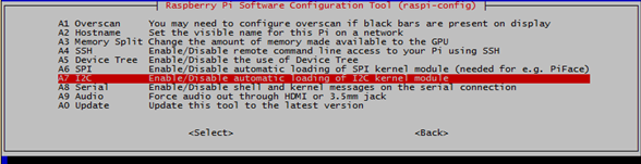

Select option 9: Advanced options. Then choose option A7: I2C.
RTC Config 2 image
Then you be asked if we want to enable I2C. Choose YES.
RTC Config 3 image
Get out of raspi-config. In the next restart of the system i2c modules will be loaded by default.
