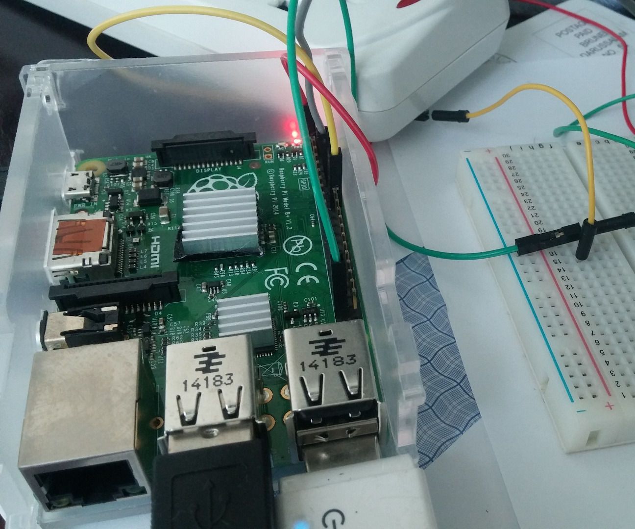

Step 5: Sequence to Get Started
First get your assemble work on breadboard.
Refer the attached circuit diagram that I prepared. This has all the pin connection details Raspberry PI, IR Sensor, LN298 motor controller.
Start with IR remote controller working first. Check if you can press remote keys and the pyhton code in Raspberry PI.
Once it start working start testing your motor controller. Assemble you DIY motor car. I used a car with 2 motors. There 4 motor cars as well in online markets. If you use it plan for a better battery power sine it may need more power.
Once the car is assembled check if the motor and wheels moving by giving 5Vs to motor.
Next connect the LN298 motor controller to Raspberry PI.
For testing and trouble shooting of PWM out puts you could have simple LED with Resistor connected parallely to the PWM outputs. If you are interested further analysing PWM and other GPIO outputs you can try using USB Logic Analysers. There are low cost USB Logic Analyzer Devices (24Mhz) you can buy online. I used one and installed software in my laptop. Software also you can download from internet. It is a very handy debugging tool to have.
