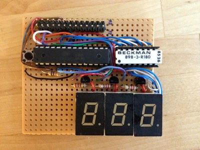

This build uses 3 modules of 7-segment common Anode LED displays that are controlled by an Atmega328. We use 3 because normal home LANs are C nets with a maximum of 256 devices and I had 3 of these nice 7-segment displays lying around. :)
The (AVR Atmega) 328 is loaded with the Arduino bootloader on an Arduino Uno 28pin AVR and then programmed with the Arduino 1.0.1 IDE through the Raspberry Pi on board serial port. The software is the firmware that Sparkfun uses on their serial backpack, but we have to modify a couple of lines since they use a 32 pin SMD 328 instead of the normal 28pin DIP version from the UNO.
By using an 328 for this, we do not need more than the serial port's 2 pins to control the display, and all multiplexing and buffering is done by the 328. No need for a program to do the multiplexing of the 7-seg displays and be problematic with irregular timing. We can also use the built in i2c bus to control it if we want to.
Using the serial port makes it very easy to display 7-seg chars on the display, remaining there until we update it again. This is great for piping information from scripts, and we do not need a program running constantly as a daemon.
You could of course buy a single 4 digit display from SparkFun ready-made and connect it to your Linux box or your RPi, losing all the DIY fun. That is totally up to you. :)

Step 2: Schematics/connections
What is connected to the 328 on our build:
- 10K resistor +3.3V / Switch GND
- RPi TXD pin 8
- RPi RXD pin 10
- LED dp -> pin 8 DIP resistor
- LED seg 3 transistor base resistor
- NC
- +3.3V
- GND
- NC
- NC
- LED g -> pin 7 DIP resistor
- LED c -> pin 3 DIP resistor
- LED f -> pin 6 DIP resistor
- LED a -> pin 1 DIP resistor
- LED e -> pin 5 DIP resistor
- NC
- NC
- NC
- NC
- +3.3V
- +3.3V
- GND
- LED b -> pin 2 DIP resistor
- LED d -> pin 4 DIP resistor
- LED seg 1 transistor base resistor
- LED seg 2 transistor base resistor
- RPi SCL pin 5 (optional)
- RPi SDA pin 3 (optional)

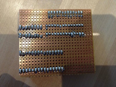

Step 3: Cut Out a Piece of Perfboard and Start Soldering
Decide on a size you want by placing your components on the perfboard and cut it out with a knife or saw.
I have a Olfa plastic cutter I really love for things like this, but a normal sharp knife works fine.

Step 7: Connect Display to RPi and Test It.
- Power down RPi
- Connect ribbon cable between RPi and Displayboard
- Power up the RPi without SD card, just to see that the Displayboard works
- The next steps can be done when you have the AVR 328 loaded with the Serial7SegmentDisplay firmware:
The firmware shows 1 2 3 on the modules before anything is sent on the serialport.
If this shows up, you know everything is OK and that you have connected everything right.
- When the Displayboard works, boot up with SD card and log in as normally.
- There could be strange chars displayed on it as the RPi boots, this is normal.
- Manual test to display 123 on display
