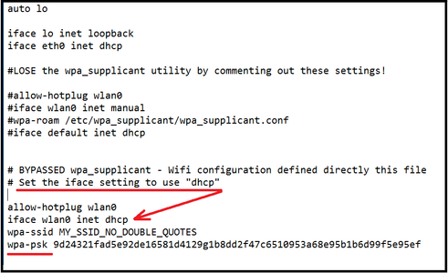

Step 7: Configuring the Wifi Settings
The next step in the configuration is to edit the /etc/network/interfaces configuration file using the nano text editor and plug in the PSK setting.
$ sudo nano /etc/network/interfaces
Comment out or delete the wpa_supplicant settings with the # sign. Add a useful comment to record the intent of the setting change:
#LOSE the wpa_supplicant utility by commenting out these settings!<br>#allow-hotplug wlan0<br>#iface wlan0 inet manual #wpa-roam /etc/wpa_supplicant/wpa_supplicant.conf #iface default inet dhcp
Configure the Wifi settings using the PSK value generated in the last steps:
# BYPASSED wpa_supplicant - Wifi configuration defined directly this file # Set the iface setting to use "dhcp" allow-hotplug wlan0 iface wlan0 inet dhcp wpa-ssid MY_SSID_NO_DOUBLE_QUOTES wpa-psk 9d24321fad5e92de16581d4129g1b8dd2f47c6510953a68e95b1b6d99f5e95ef
Save and close the /etc/network/interfaces file.
With the settings saved, the configuration file should look like the one in the image.
