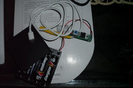

- 5v Regulator + 4 x AA battery box + some solder wire and some duct tape & a wire cutter/stripper for connecting the wire between the Raspberry Pi jack and the regulator and the battery box which will need some soldering and covering the soldered parts with duct tape (Option 2 - In case you want to make a portable power source by yourself, a picture of one I did down there)
