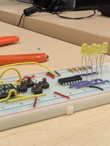

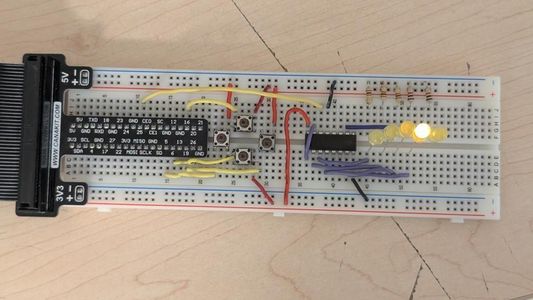

Step 1: Build the Circuit
Build the circuit as shown in the photo.
Connect the T-Cobbler to the breadboard and then connect the ribbon cable to the GPIO Pins on the Pi with the T-Cobbler pointing away from the Pi.
Pushbutton:
  1. Up: GPIO 16
  2. Down: GPIO 6
  3. Left: GPIO 5
  4. Right: GPIO 19
Decade Counter:
  1. Pin 16: 3.3v
  2. Pin 8: GND
  3. Pin 14: GPIO 25
  4. Pin 13: GND
  5. Pin 3: LED 1
  6. Pin 2: LED 2
  7. Pin 4: LED 3
  8. Pin 7: LED 4
  9. Pin 10: LED 5
  10. Pin 1: Pin 15 (RESET)
