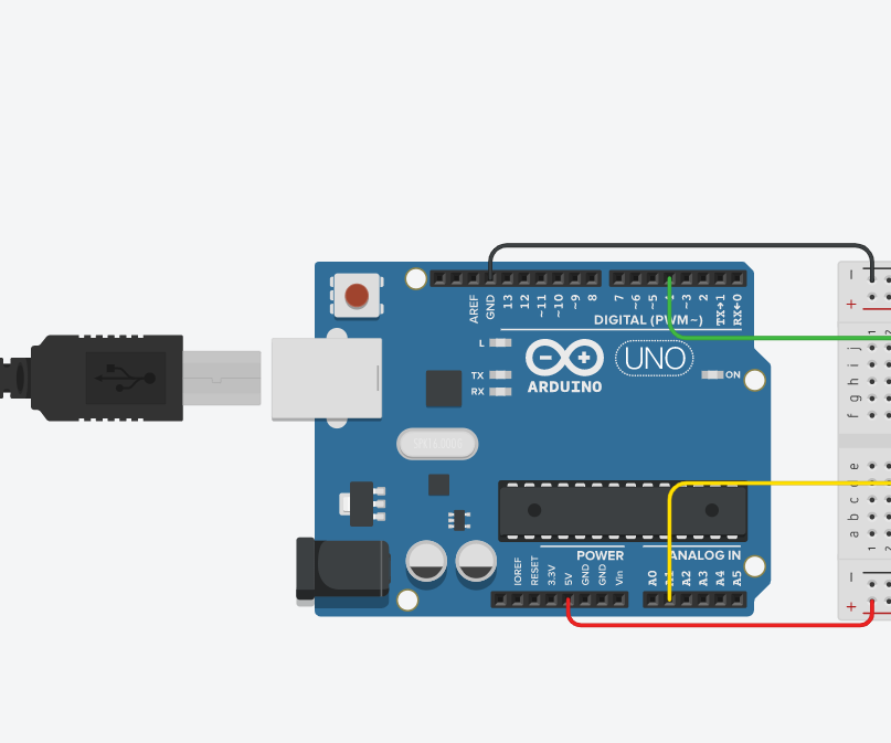

The Circuitry is relatively simple but I will still explain it -
Servo: To wire the servo you will need the servo itself and three jumper cables. First, put each of the jumper cables to the three wires on the servo. After, look at the colors of the servo, brown = ground (GND), red = voltage (5V), and orange = GPIO.
Button: To wire, each of the buttons takes one jumper to connect it to a GPIO port and connect it to one peg on the button. Then, take another jumper to connect it to ground and place to the adjacent peg of the GPIO peg. Do this again two times to the other two buttons and connect them to two different GPIO pins.
LED: To wire the LED you will need two jumpers (one for ground and one for the GPIO pin), a 330-ohm resistor and the led its self. start by taking one of the jumper cables and putting it to ground then connect that wire to the resistor. After, take the led and connect the smaller peg to the resistor then take the second jumper cable and connect it to a new GPIO port (different from the servos and the buttons) and connect the other side of the jumper to the other leg of the LED.
Hint: You can use two more jumpers to extend the ground and a GPIO port to the side of the breadboard.
