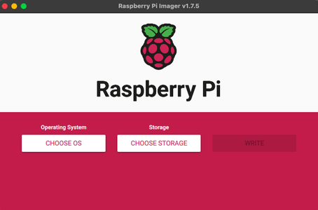

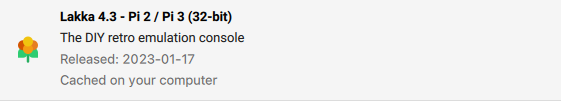

When the raspberry pi app is done downloading click on something called( CHOOSE OS) once you have clicked on that it will show you one of the many software you can install on your raspberry pi but for this project will choose something called Emulations and game OS. once you have clicked on the emulation click on the software called lakka once you have clicked on lakka it will show different versions click on the one that says (Lakka 4.3 - pi 2 / pi 3 (32-bit)) after that it will bring you back the the main menu once your in the main menu click on (CHOOSE STORAGE) then pit in your micro sd card in the miro sd card reader then put in your computer of choice after that click write( for mac it may ask for you administration code so just put in your code)
