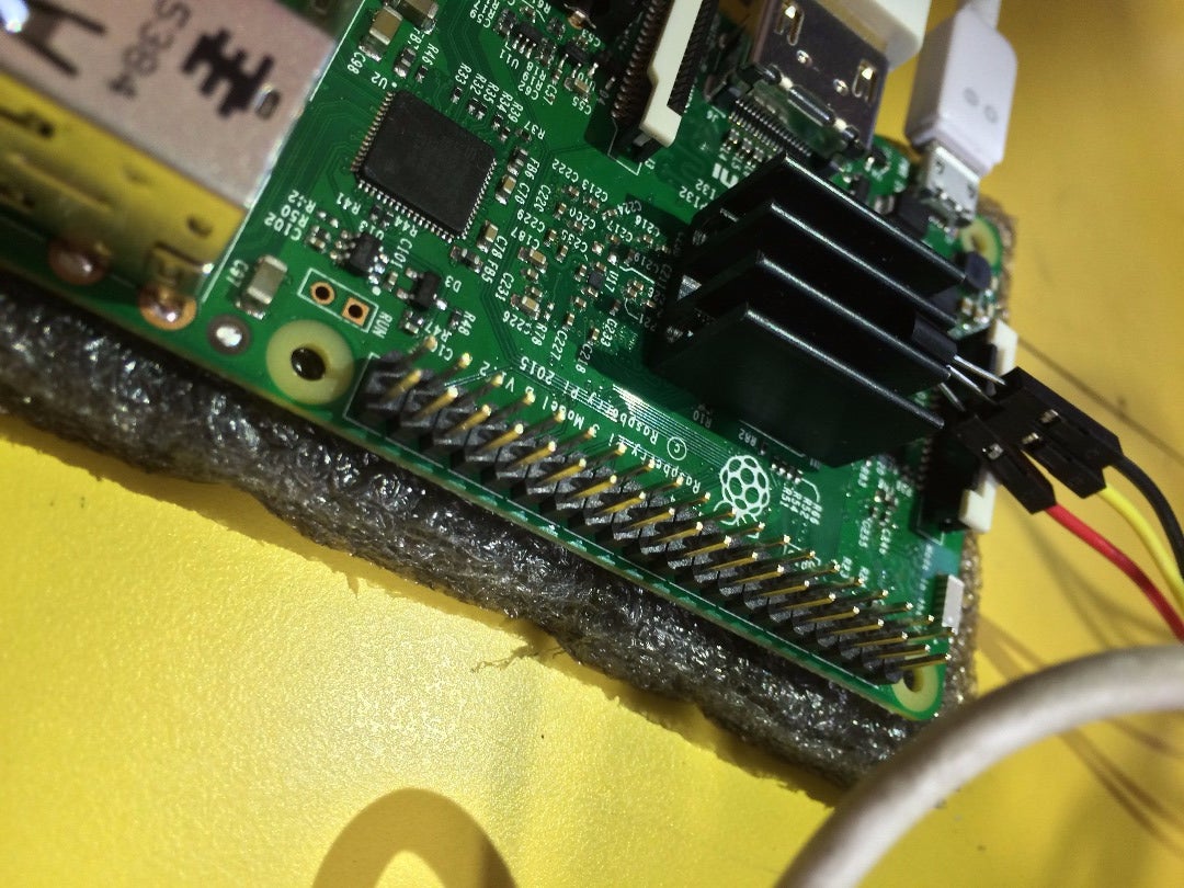

- Before we begin please note that I have monitored only the CPU+GPU package and the thermal output of your RasPi may vary according to the model (I have covered only the Pi 3) and the utilization of the CPU by the programs.
- Note that this is passive type of cooling as only a heatsink is used(no fans) and your temperatures might vary according to the type and/or size of the heatsink.
- I had created a temperature monitor with SD card datalogging on the Intel Edison recently, so instead of using the RasPi as a monitor, I used the Intel Edison with an LM35 Transistor as a temperature sensor while using the RasPi independently.
- I had to keep it as simple as possible, so for testing, I booted up into Raspbian and played Minecraft until the CPU temperatures settled at a maximum which, in my case, was about 20 minutes.
- Note that the "ambient temperature" in which i was working was about 32 degrees celsius.
- I have attached a heatsink to the SoC and an appropriate amount of thermal paste to it.
- In this test, i'm not pushing the Pi to its limits, as i had to do a real-world testing and so for your information I'm telling that I have noted the CPU temperatures going as high as 65-70 degrees celsius when installing Raspbian and certain high performance applications .
