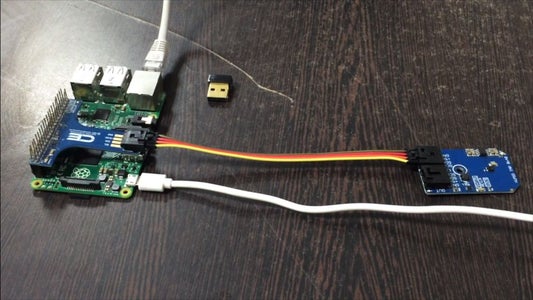

Step 2: Connections:

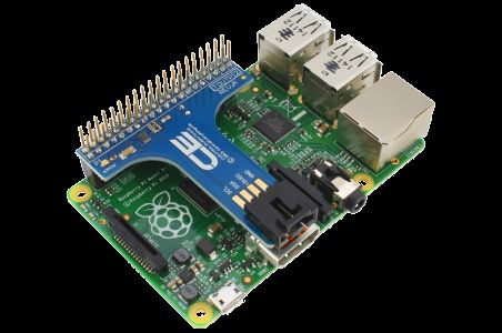

Take a I2C shield fo raspberry pi and gently push it over the gpio pins of raspberry pi.
Then connect the one end of I2C cable to A1332 sensor and the other end to the I2C shield.
Also connect the Ethernet cable to the pi or you can use a WiFi module.
Connections are shown in the picture above.
