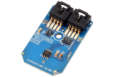

AD7416ARZ is 10-Bit temperature sensor with four single channel analog to digital convertors and an on board temperature sensor incorporated in it. The temperature sensor on the parts can be accessed via multiplexer channels. This high-accuracy temperature sensor has become an industry standard in terms of form, factor and intelligence, providing calibrated, linearized sensor signals in digital, I2C format. Here is the demonstration with a Python code using Raspberry Pi.

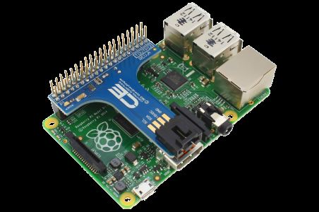

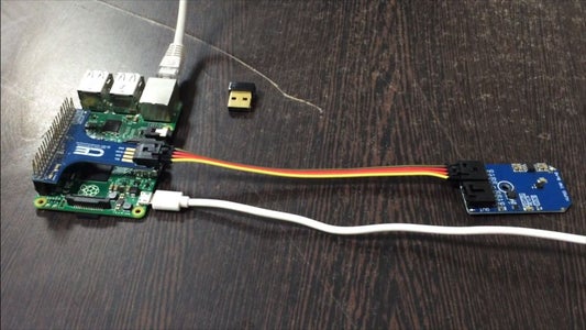

Take a I2C shield for raspberry pi and gently push it over the gpio pins of raspberry pi.

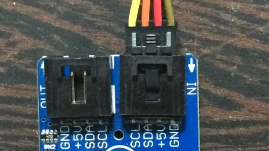

Then connect the one end of I2C cable to AD7416ARZ sensor and the other end to the I2C shield.
Also connect the Ethernet cable to the pi or you can use a WiFi module.
Connections are shown in the picture above.
