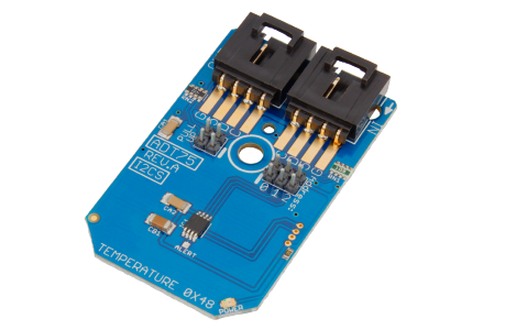

ADT75 is a highly accurate, digital temperature sensor. It comprises of a band gap temperature sensor and a 12-bit analog to digital converter for monitoring and digitizing the temperature. Its highly sensitive sensor makes it competent enough to measure the ambient temperature accurately. Here is the demonstration with a python code using Raspberry Pi.

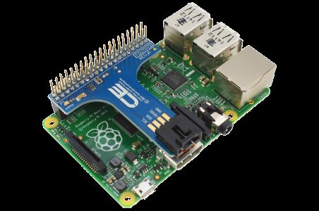

4. I²C Shield for Raspberry Pi
5. Ethernet Cable
Step 2: Connection:
Take a I2C shield for raspberry pi and gently push it over the gpio pins of raspberry pi.

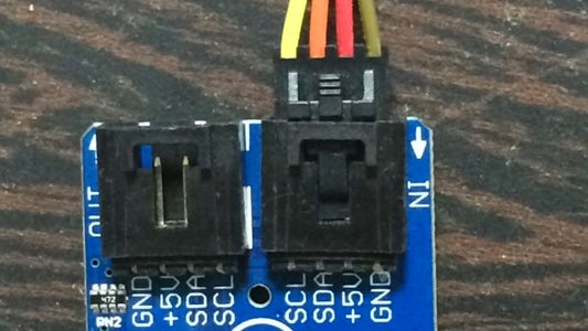

Then connect the one end of I2C cable to ADT75 sensor and the other end to the I2C shield.
Also connect the Ethernet cable to the pi or you can use a WiFi module.
Connections are shown in the picture above.
