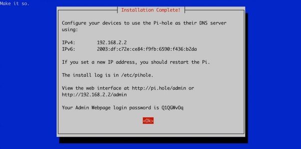

This is super important! Write down the password somewhere so you have it later. You need it!
Step 9:
It should say complete on the pi now. We are now ready to go over to our freshly installed Pi-hole Dashboard. You can access it inside your browser by typing “http://192.128.2.2/admin” or “http://pi.hole/admin”. Change the IP address according to your setup. I would use the first one, because you need to configure your DNS for pi.hole/admin, and I won't be going into that.
