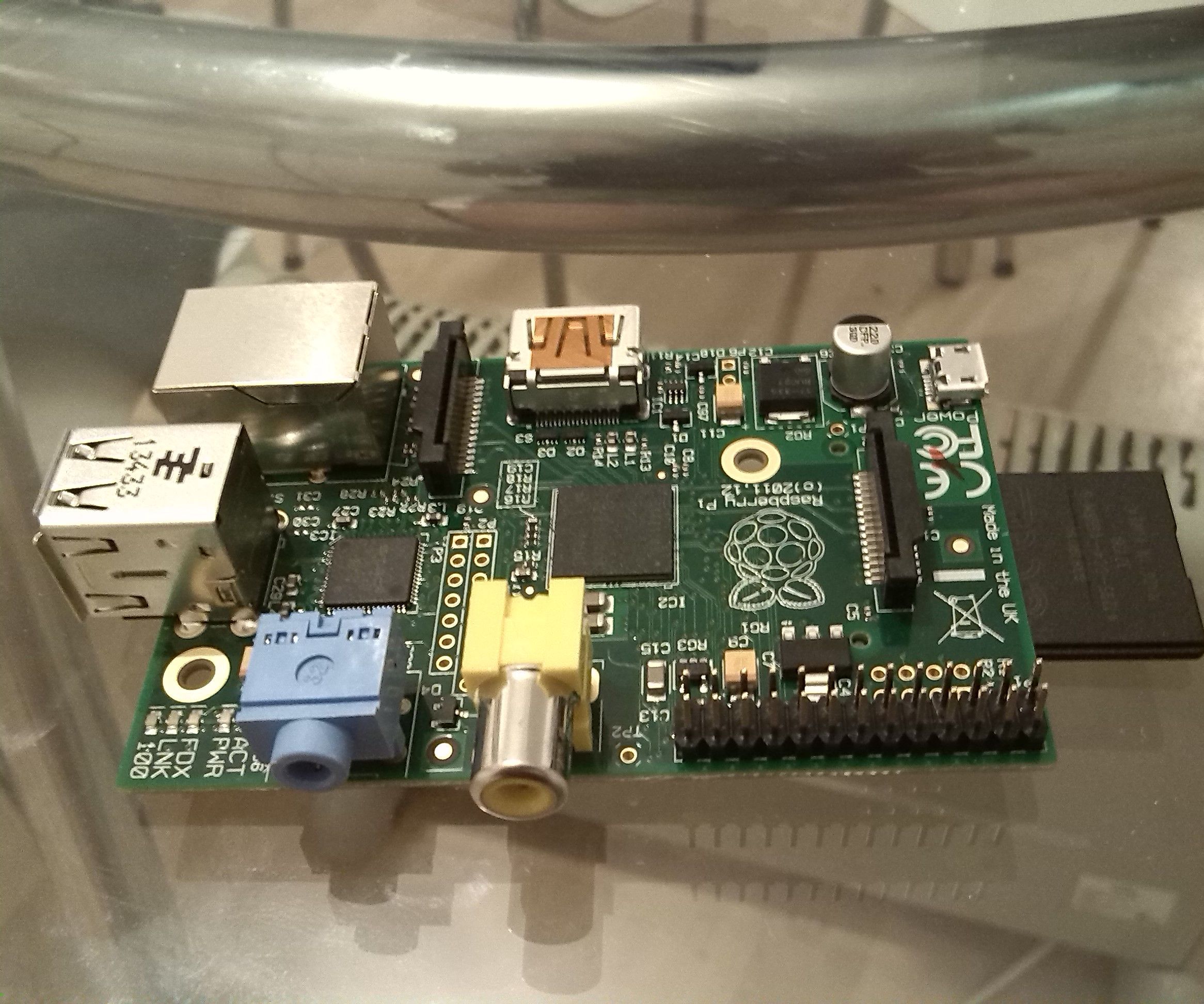

(Sorry for the bad picture quality, it gets better) To get the receiver set up, you will need these materials:
Raspberry Pi (With Ethernet)
Ethernet Cable and Router
SD Card (Min. 4GB)
3.5mm to 3.5mm Audio Cable
Computer running Win32 Disk Imager or Apple-Pi Baker
A Speaker or Stereo System
An Internet Connection
