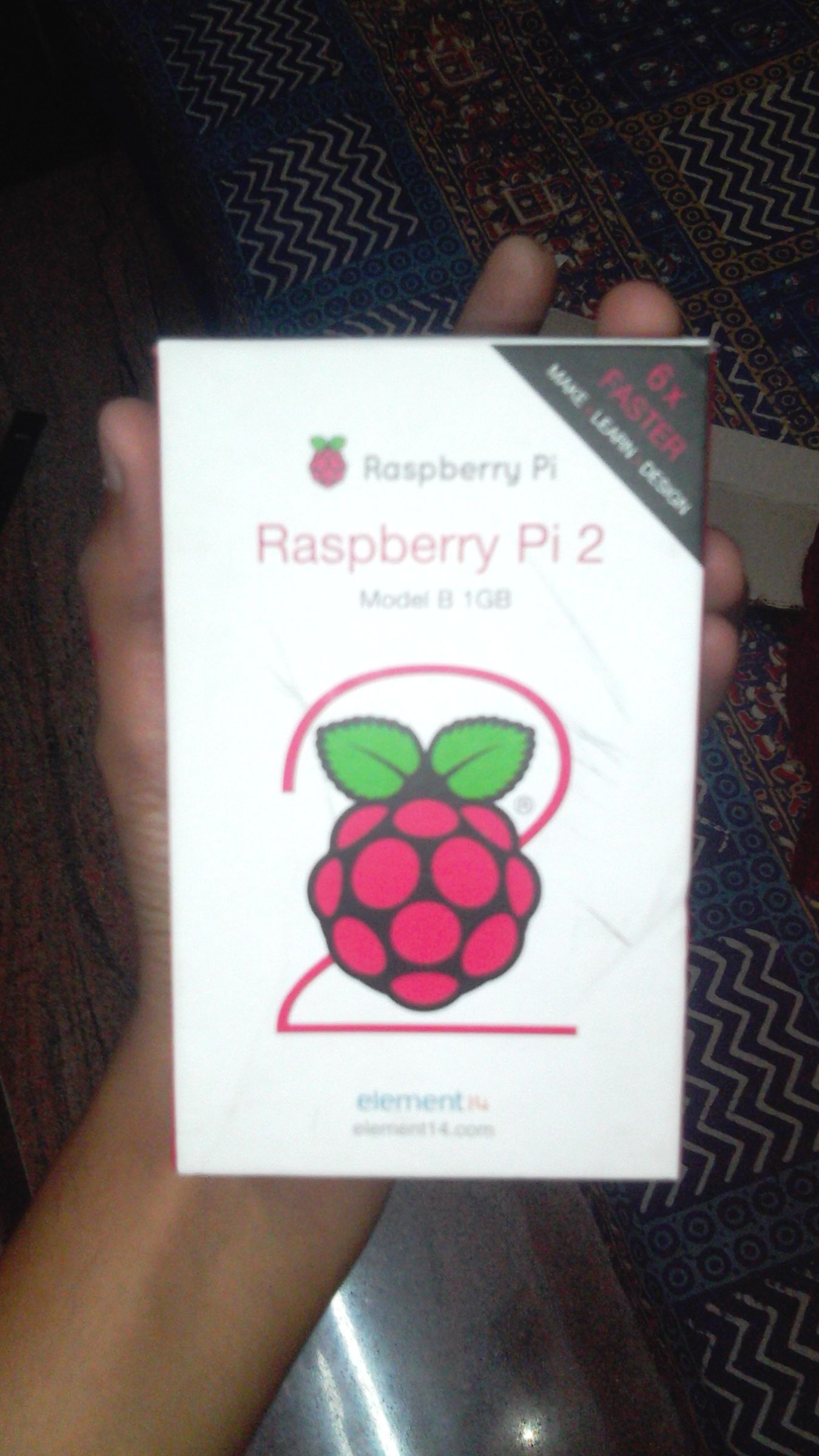

Step 1: Parts List
This project does require a bit of time to do, and the total budget will be in the ballpark of around 95-120 USD depending on which part of the world you live in, and the full part list is given below.
1x Raspberry Pi (variant of your choice but the Model A and B don't work yet, will work in the near future)
1x Official Raspberry Pi Touchscreen (the one that uses the DSI port on the Pi)
1x Wi-Fi dongle (probably you would want to go with the Edimax EW-7811 because its one good dongle, and seems to have great range, I was being a cheapskate and went with a generic MediaTek MT7601 because the driver is supported in Raspbian Jessie now, so why not save money when you can?) :/
1x 5200 mAh power bank (y'know, those phone chargers that put out 5 volts through a USB port? Conditions will be mentioned later.....)
1x a suitable frame to stuff it all in (Again, I re-used a cheapo 50$ Android netbook display frame)
1x Tablet Keyboard (the ones for 7" tablets that double up as cases and keyboards, and have a USB keyboard..)
1x Micro USB Female to USB Type -A Male adapter( the ones you use to connect an OTG USB drive to your desktop or laptop)
1x Bluetooth dongle (This is optional, but the more, the merrier!)
1x Small Slide Switch(to serve as our power switch and note that this should be able to handle 5 Volts at 2 to 3 Amps. Even though the power use is much lower, it is better safe than sorry), right guys? ;)
1x MicroSD card( Class 10, 4GB minimum). I used a UHS-1 16GB card from Strontium.
An afternoon of time
A bit of patience..
I guess that is it.. Now let's get on with the build!
