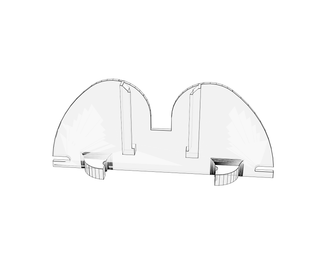

Step 2: 3D Printing Files
I've attached both the STL file and the SolidWorks part file so that you can make any edits you wish. I've thought about moving the position off-centre but I'm not sure I need to yet.
You may also want to remove the 2 "claw" type parts that I've added to grab the tabs on the top of my touchscreen.
