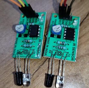

  • IR Sensors

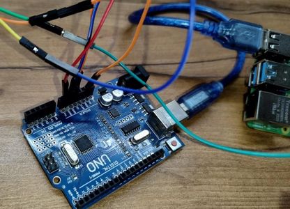

  • Arduino UNO (Extra)

  2. IR Sensors: The IR sensors, connected to the Raspberry Pi's GPIO pins, detect user interactions. When a user waves their hand near the sensors, the system processes the input for book issuance or return.

  2. IR Sensors:The IR sensors are typically connected to the Raspberry Pi's GPIO pins for digital input. You can use multiple GPIO pins to connect several IR sensors if needed. These sensors are used to detect user interactions like waving their hand, and the Raspberry Pi reads the input from these sensors through the GPIO pins.

  5. Arduino Uno (Extra): The Arduino Uno is used to make up for the lack of power pins the Raspberry Pi after connecting it to the TFT display. You may use any other method to other up you IR sensors.
