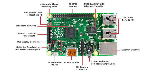

-     Raspberry pi 3 + micro SD card 16G with operating system
Raspberry Pi: is a credit card-sized, ARM-based, single-board nanocomputer designed by professors in the Department of Computer Science.
The Raspberry Pi is a low cost, that plugs into a computer monitor or TV, and uses a standard keyboard and mouse. It is a capable little device that enables people of all ages to explore computing, and to learn how to program in languages like Scratch and Python. It’s capable of doing everything you’d expect a desktop computer to do, from browsing the internet and playing high-definition video, to making spreadsheets, word-processing, and playing games.
Your Raspberry Pi needs an operating system to work. This is it. Raspberry Pi OS (previously called Raspbian) is our official supported operating system.

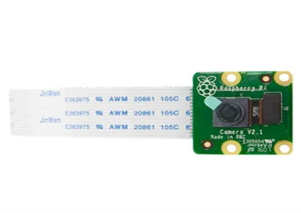

-     Pi Camera Module
The Camera Module 2 can be used to take high-definition video, as well as stills photographs. It’s easy to use for beginners, but has plenty to offer advanced users if you’re looking to expand your knowledge. There are lots of examples online of people using it for time-lapse, slow-motion, and other video cleverness. You can also use the libraries we bundle with the camera to create effects.
The camera works with all models of Raspberry Pi 1, 2, 3 and 4. It can be accessed through the MMAL and V4L APIs, and there are numerous third-party libraries built for it, including the Picamera Python library. See the Getting Started with Picamera resource to learn how to use it.

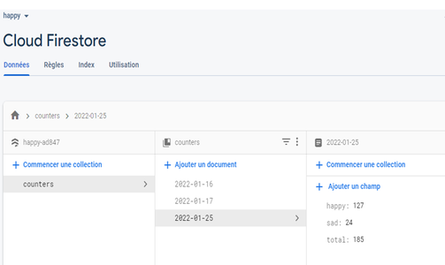

Step 6: Sending Analytics to the Cloud
In this final coding step we are going to send the data to the cloud Storage, we are using cloud firestore NoSQL database REST api.
Firebase is a development platform known originally for its realtime database that's still at its core a multi-node, key-value database optimized for synchronizing data, often between user machines or smartphones and centralized storage in the cloud.
 date =  datetime.today().strftime('%Y-%m-%d')
url="https://firestore.googleapis.com/v1/projects/happy-ad847/databases/(default)/documents/counters/" + date
if emotion_text == 'sad':
            color = emotion_probability * np.asarray((255, 0, 0))
        elif emotion_text == 'sad':
            sad = sad + 1
            total = total + 1
            print('sad = ' + str(sad))
            payload = {
            "fields": {
            "total": {"integerValue": str(total)},
            "sad": {"integerValue": str(sad)},
            "happy":{"integerValue": str(happy)}
            rsp = requests.patch(url,data = json.dumps(payload))
            color = emotion_probability * np.asarray((0, 0, 255))
   elif emotion_text == 'happy':
            happy = happy + 1
            total = total + 1
            print('happy = '+ str(happy))
            payload = {
            "fields": {
            color = emotion_probability * np.asarray((255, 255, 0))
now we will execute the code:
python3 happy_sad_cloud.py
and we will see the results in the cloud as shown below

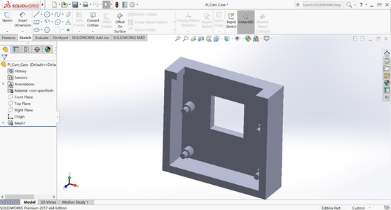

Step 7: Design for 3D Printing
After installing Solideworks ,which is a mechanical design automation application that lets designers quickly sketch out ideas, experiment with features and dimensions, and produce models and detailed drawings.I start by taking the camera measures and then continue with the modeling in Solideworks.
Before sending the file in the 3D ,we need to export to .stl File.
I'll use XYZware Software.
Step 8: Sending the File in to 3D Machine
Finally we are printing a 3D object for the camera.
