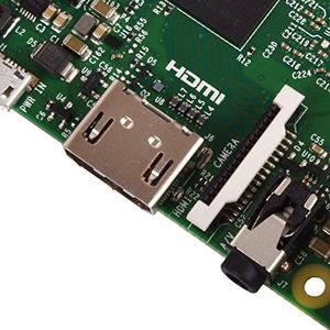

When you are making something like this , you will find something that is already on your desk . I have used Raspberry pi 3B which is popular and have a large community who can answer if you stuck at somewhere , Along with Pi i have used pi camera , waveshare 7" Touchscreen and a printer.
RASPBERRY PI
PI CAMERA
WAVESHRE 7" Touch Screen
