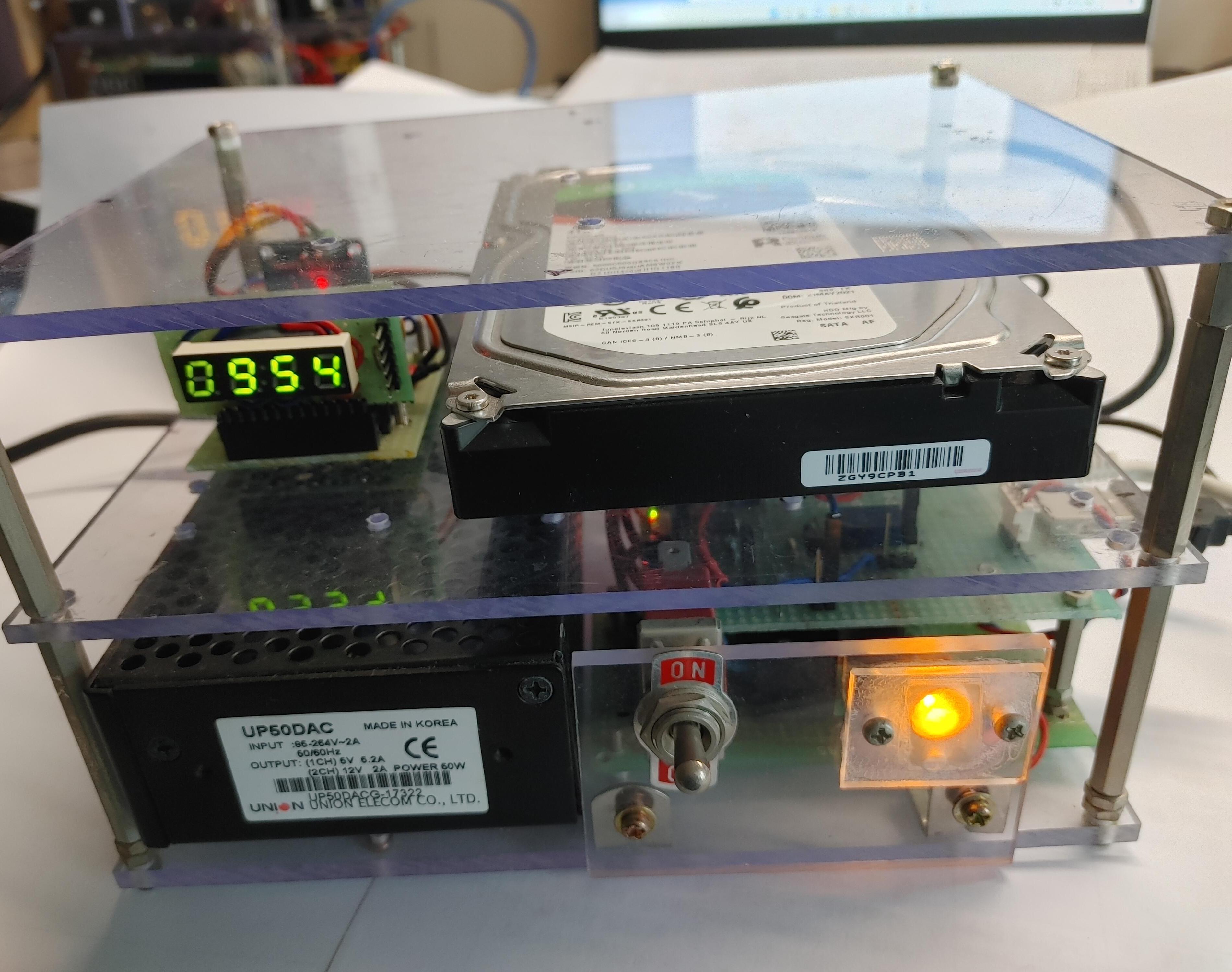

That’s why I’m making this small torrent server box (size about 15cm(W) x 10cm(D) x 12cm(H)).
This is second upgrade from the first torrent server box I had made before.

This project is final outcome by combining all previous work results to make unattended and heavy duty kind of torrent server.

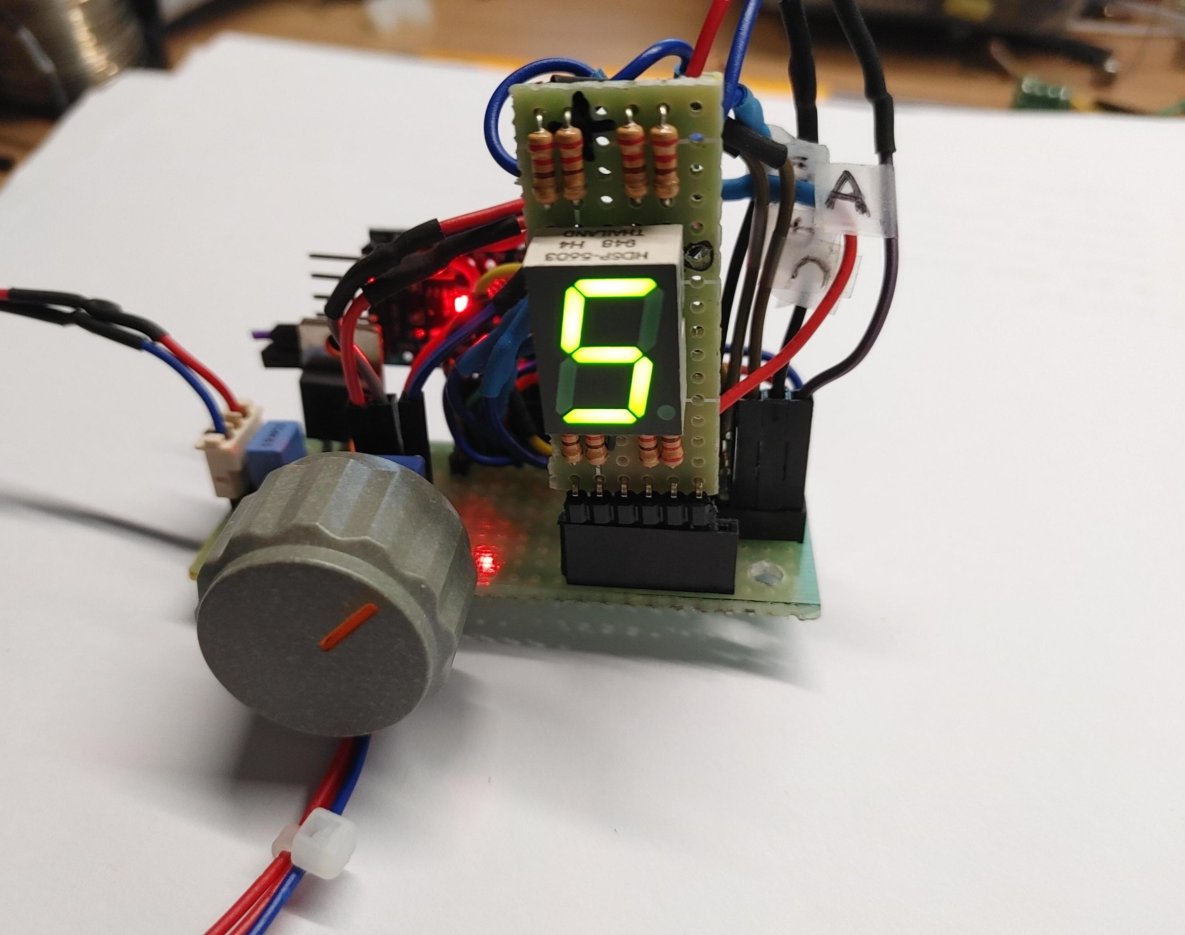

The completed torrent server version 2 is using RPI and Arduino together.
Basically RPI is used for running transmission server to download files.
Arduino is added for showing disk usage level and number of download finished files.
RPI and Arduino is communicating via USB serial port for sending/receiving disk usage and file count data.
Cooling FAN control circuit and FAN operation indicator is also included to support diverse visual indication.
According to the LEDs status as shown in the head of this page, less than 60% of 240GB SSD disk space is used, three download finished files are available and FAN is operating currently.
With self descriptive indications of the torrent server, frequent remote terminal connection and running this or that commands are not necessary.
This server will operate as unattended manner with own power supply and LAN communication link to download files for all day long.
