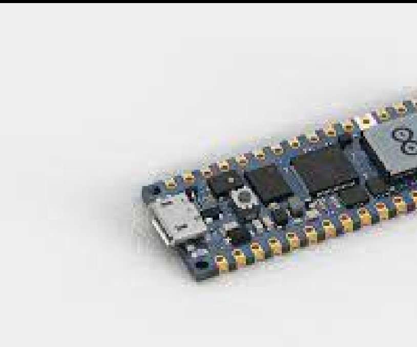

  • Adafruit Bluefruit CPB with CircuitPython Installed*

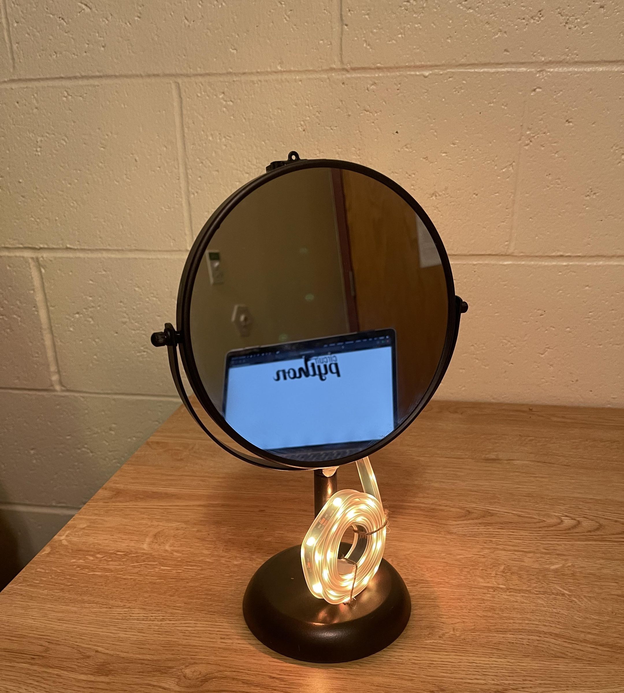

Step 4: Optional CPB Light Setup
What is more important than a photo? Looking good in a photo! The optional CPB-controlled light strip ensures that your Raspberry Pi Camera Board captures you in the best light.
  1. Attach the ends of the light strip to the CPB, and attach the CPB to a computer.
  2. In a CircuitPython script, define the light strip (location, connection, number of lights, etc.) and define two buttons (A and B) as the two buttons on the Bluefruit CPB.
  3. In a "while True" loop, set up the button responses such that an initial press to button A or B lights up the strip in Amber and White, respectively, while a second press from either button turns off the light strip.
  4. Attach the CPB and light strip to your camera board (via zipties, drilling holes, tape, etc.), and plug the rechargeable battery into the CPB to provide power.
Congratulations! You now have a rechargeable lightning strip attached to your Raspberry Pi Camera Board. Specific code is attached below, for a more detailed follow-through (note that there might be slight variations between the provided code and your final code, due to possible differences in components).
