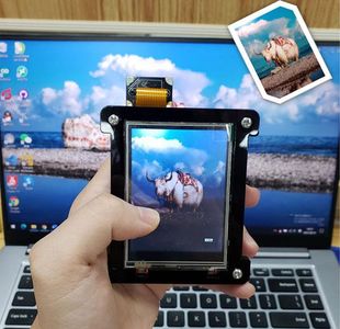

Step 5: Take Photo
I prepared a light lithium battery for Pi, that can carry outdoor and take photos everywhere. Press the screen center, it will take a photo and show it on the screen.
