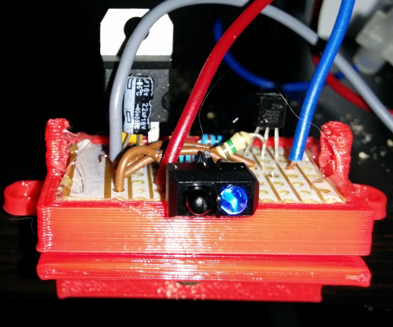

A relay controls power to the Pi, one of the Pi's GPIO pins powers a transistor which keeps the relay on until shutdown. Simple enough? Ok, read on for the circuit...

Here is the sketch of the circuit.
Parts you will need are:
- Some Vero/Proto/Bread Board
- Resistors (1/8Watt will do) 3k3,4k7 & 10K
- Transistor 2N2222
- Relay JRC-21F
- Capacitor 1000uF
- An LED
- 2 Push button switches
- Some Wire
- Connectors (I used JST's)
Power to the Pi can be fed through either the GPIO 5V & Ground PINS or you can splice and re solder a micro USB cable.

When the Pi powers down the GPIO the capacitor will start to discharge, with this setup allowing almost 8 Seconds till the capacitor discharges and then the relay is powered off.
Step 5: The Math...
The Relay used is a JRC-21F. According to its datasheet its coil needs 0.22W of Power @5V to operate. So around 44mA of current.
The 2N2222 Transistor has an HFE (gain) of around 56 at 5V and at 60mA current drain. (Figures taken from the datasheet and interpolated between tables)
The Pi is setup with a 3k3 Ohm resistor, with its output at 3.3V the current is 0.001A or 1mA.
1mA fed to the Transistor with a gain of 56 gives us 56mA of current therefore enough to power the coil requiring 44mA.
Capacitor Discharge - this is a little more complicated to put in text. Initial Current drawn is at 1mA, as voltage drops current draw increases. Using an online calculator, discharge time is at 7.9 Sec.
