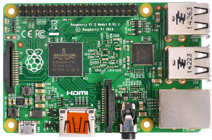

My old clock broke, and when I looked online there were no good digital clocks. I decided to make one with a raspberry pi 3b+, a screen, and a simple circuit.
Raspberry pi 3b+ $30
3.5 inch touchscreen for raspberry pi (HDMI) $20
SD card $1
Powerboost 1000 basic $10
3.7v battery for powerboost $8

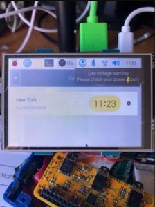

You need a clock software for it, I found the best to be GNOME clocks. To install open terminal and type
sudo apt install gnome-clocks
Once that is done go into accessories on the raspberry pi menu bar. You should see a button labeled clocks. Click it and GNOME clocks will run. Set which state you live in and it will tell the time. Open up accessories and you can move the clock button to the center of the screen so you do not have to get to it, you can just click it.
