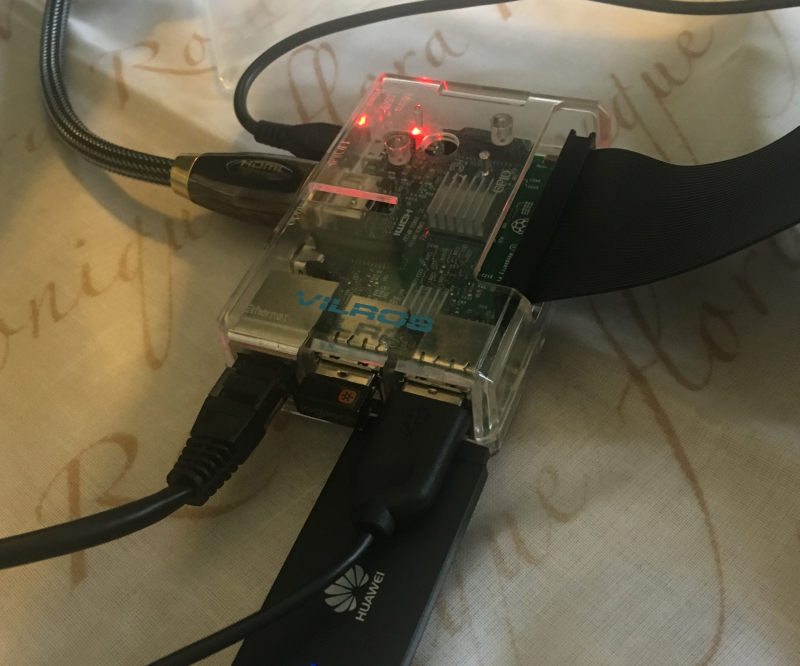

Introduction: Raspberry Pi Communicates With Pi Zero and Amp Zero, Triggering Playing of Audio
Hi, I made this as a component for my elephant detection system. The aim was to use it to play sounds of bees in order to scare away elephants when they try to steal crops! But, the general idea might be useful to adapt to many other applications!
You can see the entire thing working in the video above!
My elephant detection and deter project is here: https://hackaday.io/project/20448-elephant-ai
* please let me know if you get stuck, I've dealt with various errors, so should be able to help!
