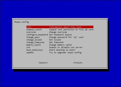

Step 1: Optionally Setting Up SSH
If you don't want to do any of this through SSH, you can opt to simply hook a keyboard, mouse, and monitor to your pi, but I found that using it remotely from my laptop was more convenient. However, if you do choose to use ssh, make sure it is enabled on your pi.
In a shell, type:
"sudo raspi-cofig"
A menu will come up in which you can choose to enable SSH.

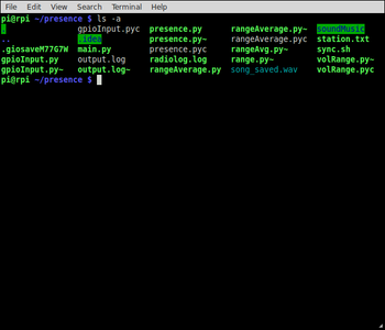

Step 3: Getting the Code
Create a directory on your Pi and extract the attached archive into it.
I extracted mine to
/home/pi/presence
I extracted mine to
/home/pi/presence

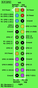

The green picture is a reference sheet for the Pi's GPIO pins. I would recommend putting a piece of insulation over the two 5 volt pins, because if you accidentally short 5 volts into another pin, it could brick your pi.

2) First, hook up your LED's. Place a jumper wire between pin 11, 12, and 13 on your pi (labeled on the reference sheet above as GPIO 17, GPIO 18, and GPIO 21/27, respectively) and your 100 ohm resistors. Don't forget to hook up the 3 volt and ground pins to the power and ground buses on your breadboard. Then put an LED between each of the resistors and ground.
It should look like this:
PIN 11 -----resistor------LED----ground
PIN 12 -----resistor------LED----ground
PIN 13 -----resistor------LED----ground
