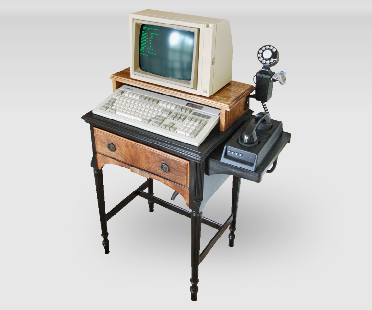

I recently acquired an early 300 baud acoustic coupler (how modems worked before you were allowed to connect modems directly to a phone jack). Let's dust it off and build our own dumb terminal using an old phone, the coupler, a Raspberry Pi, some wires, a few capacitors, a serial transceiver chip, and some solder!

The antique Novation 300 baud acoustic coupler modem relies on a DB25 RS-232 cable for serial communications. So I connect a DB9 to DB25 adapter cable between the transceiver hat and the coupler.
I place a type G telephone handset into the acoustic coupler's cups.
The rest is monitor, keyboard, power, etc.
