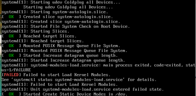

In the cmd, type in “qemu-img.exe resize 2017-03-02-raspbian-jessie.img +4G”
Press “Enter”
A small error will appear, but the resizing will take effect.
Type in “start.bat”
Press “Enter”

You’ll get a message stating that the creation of the partition failed, shut down the emulator for the changes to take effect.
In the cmd, start the emulator by starting the “start.bat” file.
Get inside the Terminal of Raspbian once it loads.
Type in “sudo resize2fs /dev/sda2”
Press “Enter”
A message will appear saying that the partition rezise was successful.
