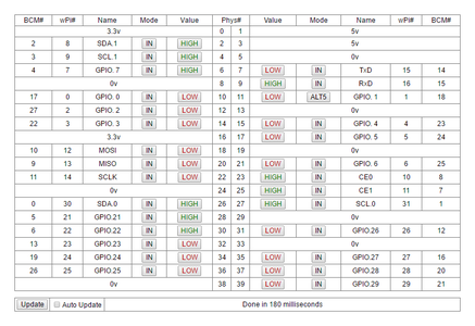

Introduction: Raspberry Pi GPIO Web Dashboard
When developing Raspberry Pi electronic projects its sometimes necessary to be able to monitor the status of the GPIO pins in "real time" and to easily turn them on and off from a simple interface.
TheFreeElectron's Simple Web Interface (https://www.instructables.com/id/Simple-and-intuitive-web-interface-for-your-Raspbe/) uses PHP and JavaScript to use buttons to control the GPIO pins.
I tried a few different combinations of systems to control before arriving at the final version:
1) Initially I tried using just PHP to display the GPIO table using javaScript to change the pins from high to low as in TheFreeElectron's instructable. However there aren't any commandline functions to read the GPIO pin modes.
2) Then I wrote a c++ script using the wiringPi library to return the pin value and mode, however this could not be used to monitor the status of the pins as the page took too long to refresh which was the only way to have PHP update the table
Finally I arrived at the system this instuctable uses.
PHP is used to generate a HTML page (index.php) containing the basis of the GPIO table.
As in TheFreeElectron's instructable, JavaScript (script.js) is used to call a PHP page (gpio.php) to change the pin values and modes.
A c++ based CGI script (gpiopinstate.cgi) outputs the status of the GPIO pins.
A PHP page (gpio.php) executes the script and converts the output into a HTML page.
This PHP page is requested by JavaScript (script.js) and the output used to set the values and functions of the value and mode buttons. The routine can be set to run repeatedly to give an up-to-date representation of the pin states and is controlled by the check box and button at the bottom.
Its far more complicated than I initially thought but it works so here we go.

<table width="80%">
<tr>
<td nowrap><button type="button" onclick="get_status()" id="update_button">Update</button></td>
<td nowrap><input type="checkbox" onclick="toggle_update()" id="update_checkbox">Auto Update</input></td>
<td width="80%"><div id="workspace" style="text-align: center;"></div></td>
</tr>
</table>The table at the bottom contains a button to manually update the table, an auto update check box that tells the system to update every 0.5 seconds and a status bar to show information.

Step 6: The Dashboard
The dashboard can be accessed from the Pi itself by browsing to the page
http://127.0.0.1
Alternatively you can use the name of the pi.
You can also find it from another computer on the network, by browsing to the IP address of the Pi or using the name of the machine.
On loading the page the table is displayed then shortly after the buttons update with the current GPIO state. At this point it is useful to click the manual update button a few times and note the time it took to process the request as displayed in the status bar below the table. Running this system on my PiZero and browsing from my laptop it takes about 200ms to process the request, running it from the Pi itself (using Chromium browser) it takes about 300ms. This time will limit the refresh rate of the table. Check the box and the table will refresh 500ms after the previous update was completed.
Now is the time to connect some LEDs to the Pi and use the buttons to turn them on and off, and to connect some push button inputs and see how the pin values are reflected in the table without having to refresh manually.
