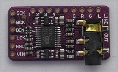

The PCM5102 module is shown as below. It has a 3.5mm jack socket for audio out.

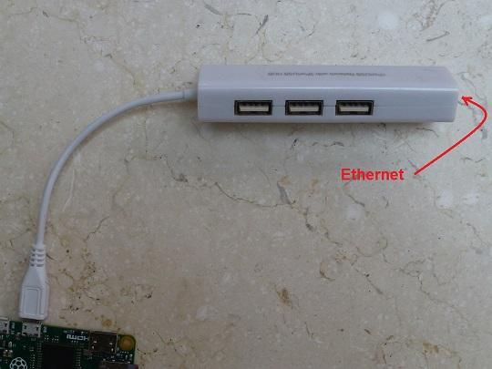

A suitable USB to ethernet dongle is this one.
Available from e.g. https://thepihut.com/products/ethernet-hub-and-usb-hub-w-micro-usb-otg-connector

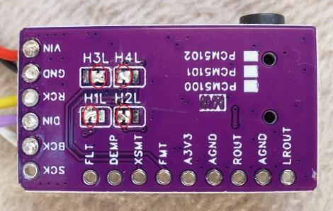

The PCM5102A module needs 4 solder bridges on the underside and one on the top. Sometimes the bottom ones are pre-soldered.
The I2S pins are defined by a dtoverlay setting later. 5 leads are required from the board - 2 power and 3 data/clocks.
| Board | Connect to | Pi | Function |
| SCK | NC | - | internal via link |
| BCK | GPIO18 | pin 12 | data bit clock |
| DIN | GPIO21 | pin 40 | data |
| LCK | GPIO19 | pin 35 | data word clock |
| GND | GND | pin 6 or 14 | Ground |
| VCC | 5v | pin 2 or 4 | Power |

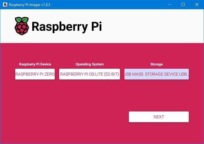

Open Imager and enter the Pi model, the operating system (Raspberry Pi OS (other)>Pi OS Lite (32-bit)) and the SD card.

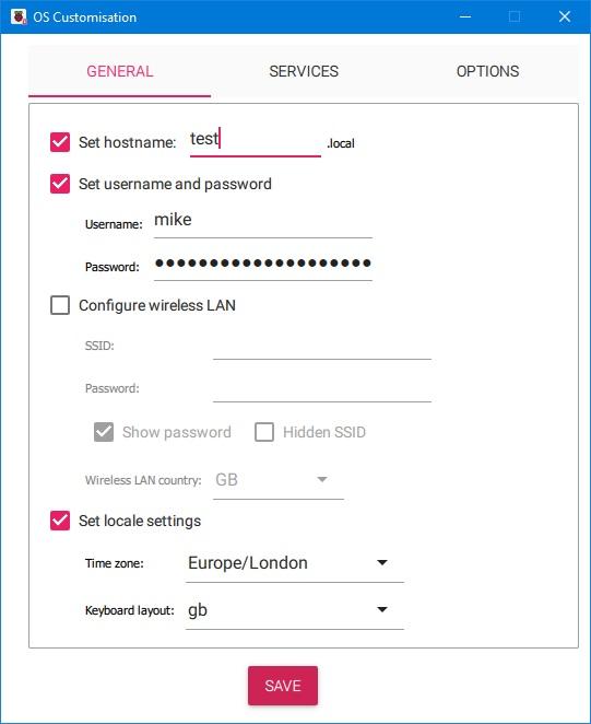

Then click ‘NEXT’ and select ‘EDIT SETTINGS’ to get the OS Customisation page. Enter hostname, username and password, WiFi details if required, and locale settings.

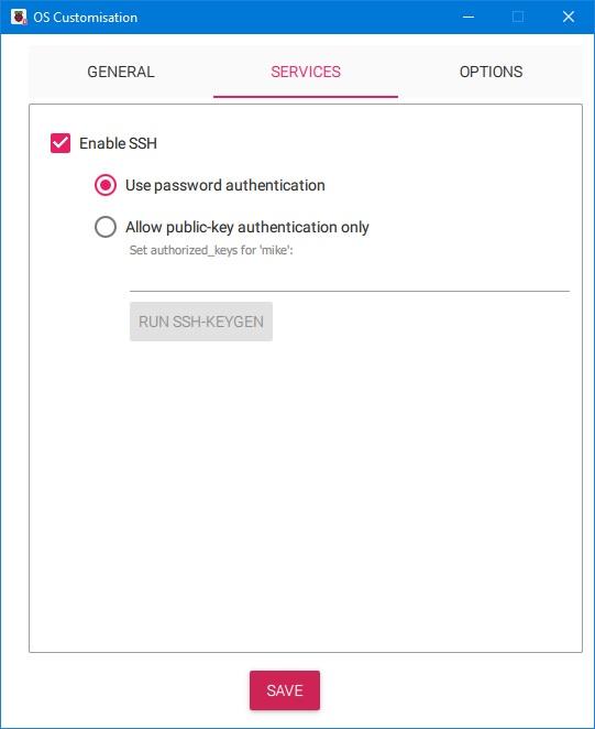

Next click the ‘SERVICES’ tab and Enable SSH and Use password authentication. The click ‘SAVE’ and then ‘YES’ to apply OS customisation settings. Then click ‘YES’ to continue to the Warning page.

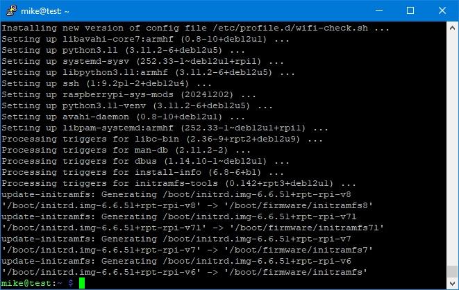

First update and upgrade:
sudo apt-get -y update
when complete:
sudo apt-get -y upgrade
The latter takes a while (10-20mins) and sometimes fails due to not getting a connection. If it fails just enter the instruction again. All done:

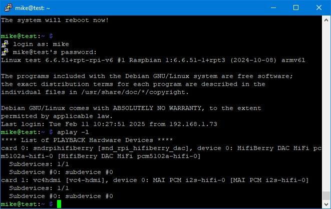

Now we can see if the DAC is connected:
aplay -l
Should give:

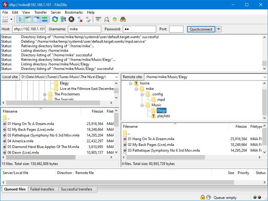

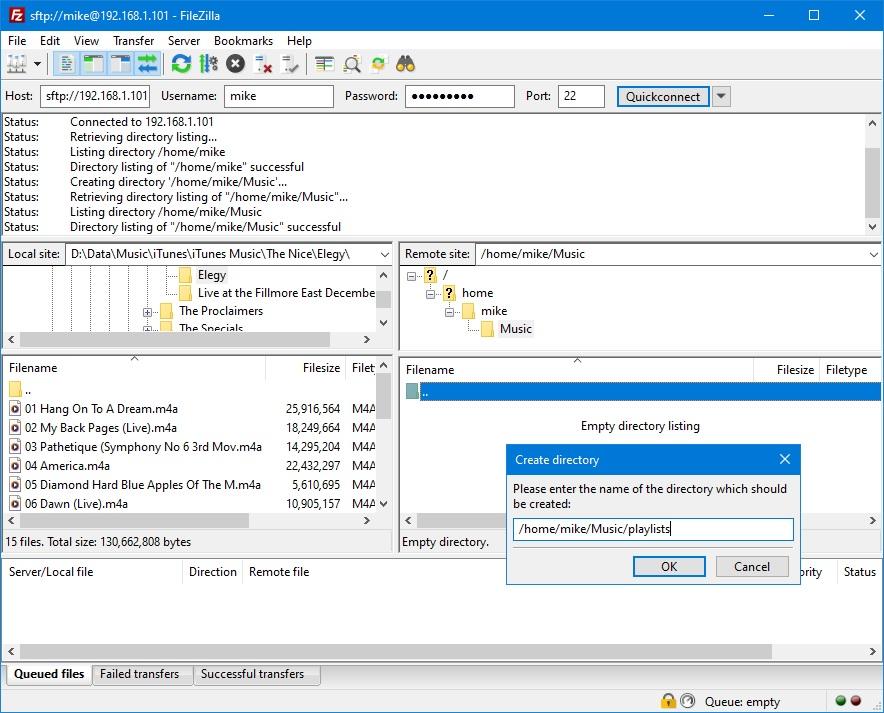

Next we need to add Music and playlists directories. This is done most easily using an ftp program that is also to easiest way to transfer music files. FileZilla is another great free open source program that will do this. Download from href=https://filezilla-project.org/download.php?platform=win64
Start FileZilla and enter the Pi IP address, username, password and 22 for the port and click Quickconnect. The Pi directory is on the right hand side. Right click in the lower box and select Create directory, then Music. Then click on Music to enter it and right click again to add a playlists directory.
Then add a .config directory and mpd directory within it. This is for additional files mpd requires.
While we are here we might as well add some music. So add a directory in the Music folder with the album name (in my case Elegy). Open the new folder and drag and drop the music files from your PC.

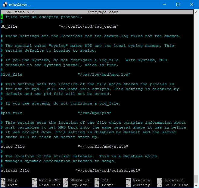

Now we have to configure MPD. This needs more editing than under Buster.
sudo nano /etc/mpd.conf
Change the music and playlist directories as below. ~ is a shortcut for the users directory.
Next change the user to the Pi’s username (mike in this case).
Now move the location of the other required files to .config/mpd/.....
Lastly go to the Audio output section and uncomment the alsa section (excepting the optional) and note the }:
^X, Y, enter to save.
