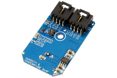

HTS221 is an ultra compact capacitive digital sensor for relative humidity and temperature. It includes a sensing element and a mixed signal application specific integrated circuit(ASIC) to provide the measurement information through digital serial interfaces. Integrated with so many features this is one of the most appropriate sensors for critical humidity and temperature measurements. Here is the demonstration with a java code using Raspberry Pi.

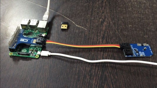

Step 2: Connections:

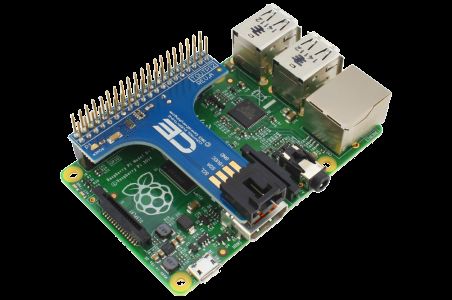

Take a I2C shield for raspberry pi and gently push it over the gpio pins of raspberry pi.
Then connect the one end of I2C cable to HTS221 sensor and the other end to the I2C shield.
Also connect the Ethernet cable to the pi or you can use a WiFi module.
Connections are shown in the picture above.
