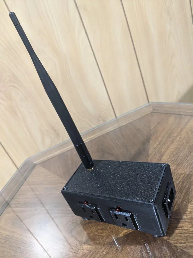

Raspberry Pi of choice (with memory card (8GB works fine)keyboard adpaters etc...) I am using a Pi Zero W tested also on Pi Zero 2W
Relay of choice (1,2,4,8)
Outlet Power Socket (snap in type, square) quantity of choice with relay.
5V 2A USB type power supply (picture in file) 1.4A measured MAX everything on and running!
Rocker Switch SPST 3Pin 15A 250VAC 20A/125VAC ON-OFF with Lamp Snap
Port for MAIN power coming in (CPU type) with cap and resistor "Obvious came from scrap"
Power cord (CPU type) "we all have tons!"
PIR Sensor Module
DHT22/AM2302 Digital Temperature Humidity Sensor
(2) Wired Door Window Sensor Magnetic Switch or reed switch
Raspberry Pi Camera of choice (I used IR cam for security purpose)
External Antenna mount on board(optional) air soldering required for this! Extreme difficult! "got parts from wfi camera board"
(U.FL/IPX to RP-SMA Female Antenna wire, antenna)
CPU Heatsink (optional BUT needed!) "I used scrap and cut to size"
(Thermal Grease CPU Heatsink Compound)
CPU micro mini fan (optional BUT needed) "15x15x5mm 5V 0.06A" (mounted using UV super glue)
(At max CPU temp with all this still can get to 105F) Without cam on it can stay under 100! As lucky as under 90F!

Step 2: Soldering
Pre cut all wires out and tin them to be ready to for soldering together. Also the tips for going into the relay MUST be tinted to ENSURE long lasting connection if not and you skip tinting your connections will fail over time about a year. I've learned this mistake from my solar panels terminal to controller. Just because there's a screw terminal doesn't mean you go all bare wire in. That can cause corrosion and ware over time of course.... GET THEM TIPS TIN!
Wiring of the Raspberry Pi
I should say that the +5 and Ground connections are self explanatory.
The relays are wired to Pins: 29, 31, 33, 37
The sensors are wired to Pins: 13, 15, 16, 18
The skill set for this project is fair middle to hard. This is not that difficult except the external antenna connection. The external antenna is optional but very nice! If you do choose although this is the toughest soldering ever I had todo! They made it even harder with the Zero2.They want you to place a surface mount resistor in the jump I just solder it directly because how hard it is. GOOD LUCK! This part can take several hours! Maybe 8.
