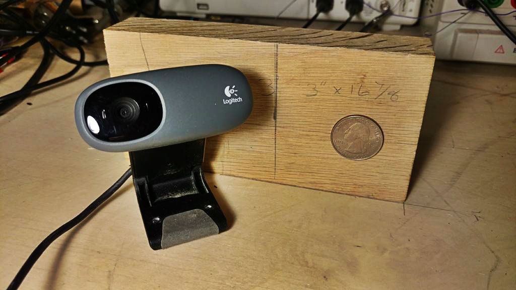

- A usb style webcam. This webcam has an adjustable foot that lets you position the camera nicely. I found that the usb cable that came with the webcam was too short for my application so I found an extension on monoprice.

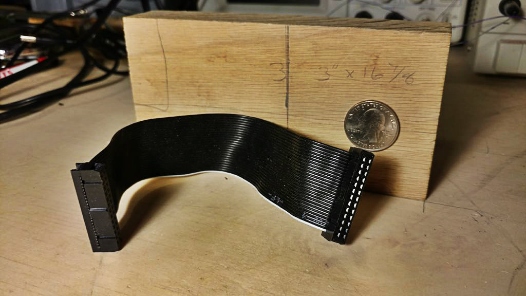

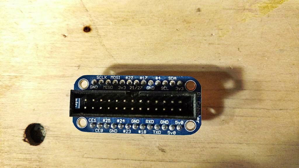

- Some sort of breakout kit for the raspberry pi so you can have easy access to the pins on the processor.

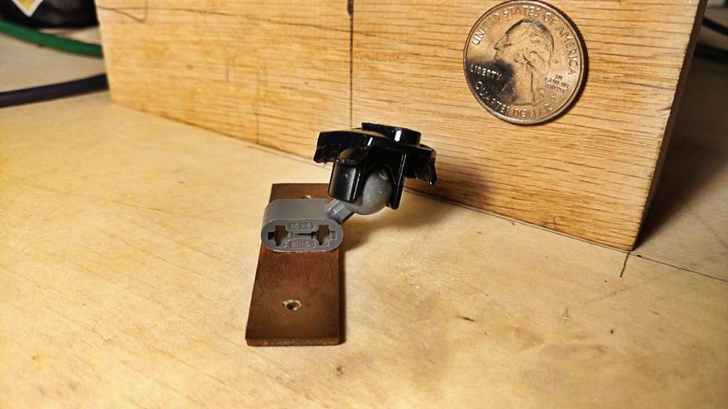

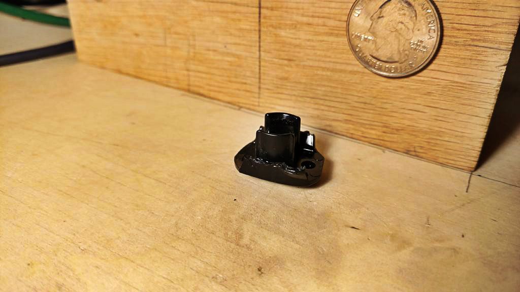

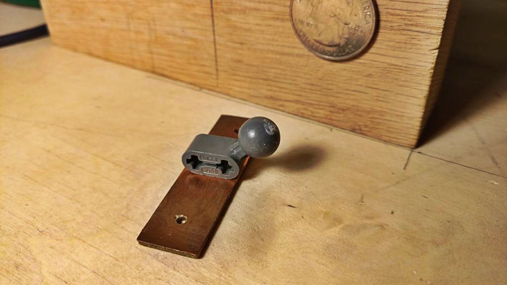

- The final step is to make a directional mounting post for the laser so it can be easily adjusted to aim at the laser receptacle. I have found that most lego bionicle kits are an excellent source for cheap ball in socket joints. Glue one piece of the ball joint to the laser pointer using super glue. Now you can mount the socket joint to any surface and snap the laser in.

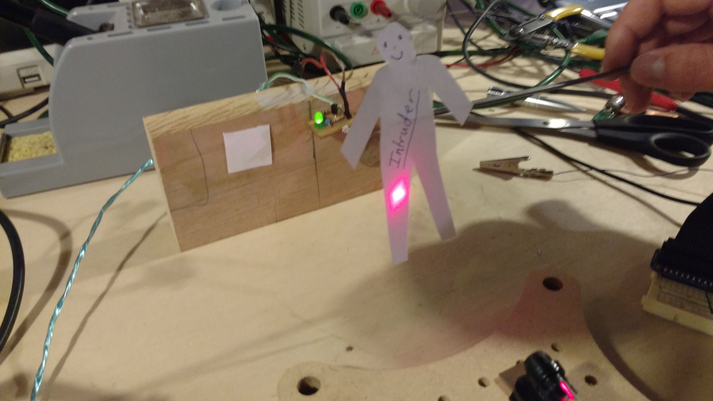

Plug the laser into your breadboard. The positive will need to be connected to 5v and ground the negative wire. If the laser turns on great, if not,double check you have the proper voltage with a multimeter. If it still doesn't work try swapping the leads in case you hooked it up backwards. If it still doesn't work you may not have soldered to the right pads, go back to the last step.
Once you have the laser beaming it is time to test the detection circuit. Aim the laser at the photodiode. The LED should turn off signaling that the beam is active. Wave you hand through the beam and the LED should turn on signaling a trip.

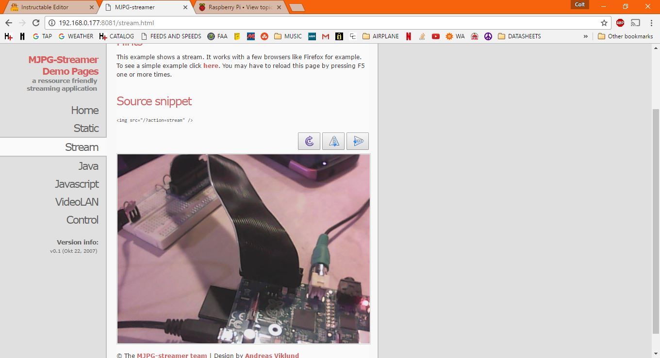

Test that the connection is working by opening a browser on another computer and enter ip-address-of-pi:8081 or on the pi you can just enter localhost:8081. If you do not know your ip of the pi enter the following in the terminal
ifconfig
If all is working you should see the mpg-streamer homepage. Click on the stream tab to see your webcam stream. Below is a screenshot of the interface.
In doing this tutorial for the second time I was able to access the mjpg-streamer home page but did not see a stream. To fix this I read this post (link now broken), specifically the part about YUYV pixel format, if you encounter a blank stream you should consult it as well.

Hook up the detection circuit to the breadboard as shown. Make sure you connect the sensor signal wire to pin 25 in preparation for the next step. The pull down resistor is not optional. I had a 10k laying around, but any resistor should do.

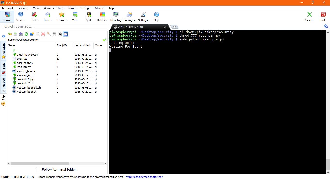

Once you have a successful install of python, download the attached python script called read_pin.py and run
cd /directory where you put the file/chmod 777 read_pin.py
The chmod command will give the script permission to run. Then test that everything is fine and dandy by running
sudo python3 read_pin.py
If all goes well you should see a console output as show below. To exit the python script enter
Ctrl-C
Wave your hand in front of the laser beam and you should see some output on the on the console alerting you that the beam has been broken. Feel free to play around with the script to get your system to perform in different ways.

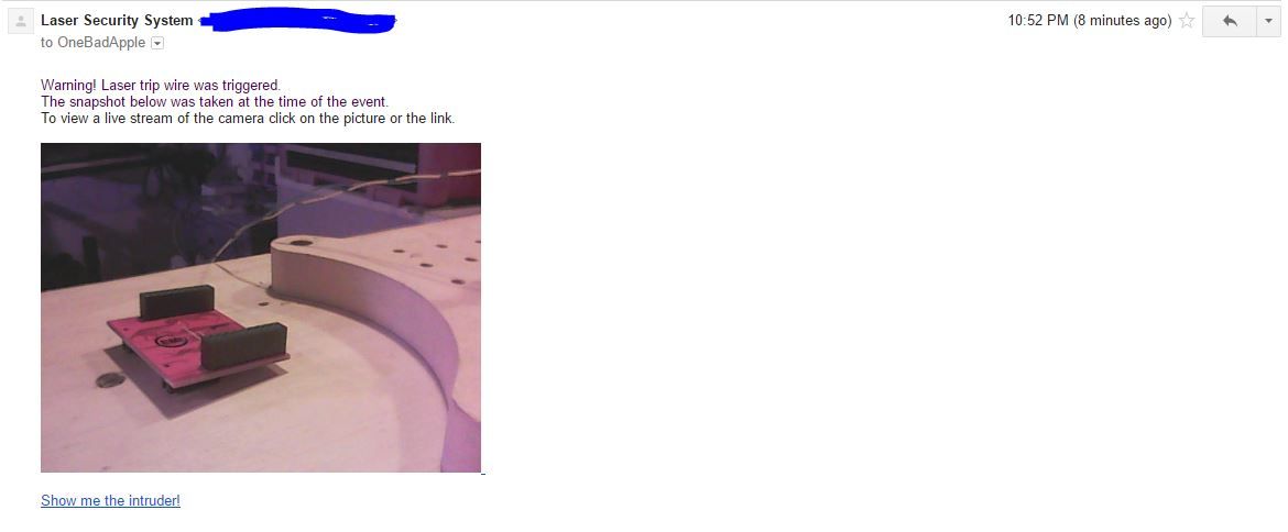

If the stars are aligned properly and all the variables are correct you should get an email similar to the one below.
There are many places where this script can fail. Do not get frustrated if it does not work the first time. Use the debugging points in the script to narrow down the problem areas and then focus on one problem at a time.
