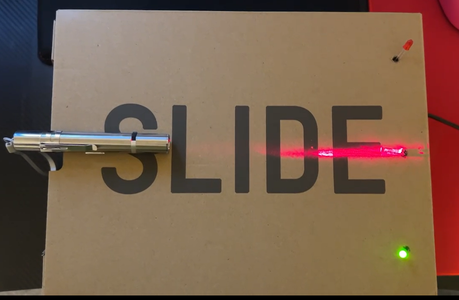

Step 6: Building the Protecting Case
It will be easy to get wires off without a protective case! You can take a box left when shopping from Amazon or a shoebox. Remember to stick everything using the tape!
Step 7: Be Creative
You can add more laser pointers and LEDs based on your needs. Then you can change the code and try use your own security system!
