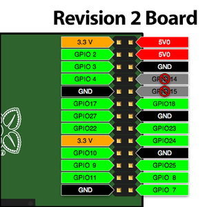

Step 4: Give Power to the Fan
It's time to give some power to the fan.
*My fan is a 12V but it will work with 5V at a lower speed.
If you use the Raspberry Pi model b rev.2 you must connect:
  1. The red cable of the fan to GPIO pin 4 - 5V
  2. The black cable of the fan to GPIO pin 6 - GND
Thats it we've done it. Start your Raspberry Pi and you will see the fan working.

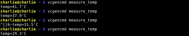

Step 5: Core Temperature - Conclusion
Lets see now if the fan is doing its job.
Open a terminal at type vcgencmd measure_temp and your core temperature will appear.
I made some simple measurements.
  1. I started with a full update and upgrade and after they finished the temperature was at 41.5 then i put the fan in power. In five minutes the core's temperature was at 29.3
  2. I started Minecraft and with scratch i tried to built a couple of blocks for about 15 minutes. The temperature during the 15 minutes was below 39.0
In conclusion this is a simple, cheap and easy to make cooling system for your Raspberry Pi.
