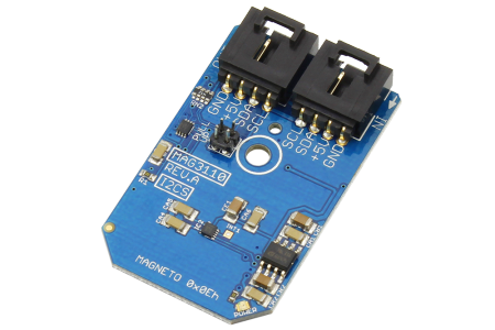

MAG3110 is a small, low power, digital 3-axis magnetometer. Its sensitivity is very high as well as it is embodied with an efficient noise reduction mechanism. It requires very low power for its efficient operation and works in single-shot measurement mode. Here is the demonstration with a python code using Raspberry Pi.

2. MAG3110

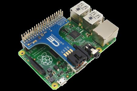

4. I²C Shield for Raspberry Pi

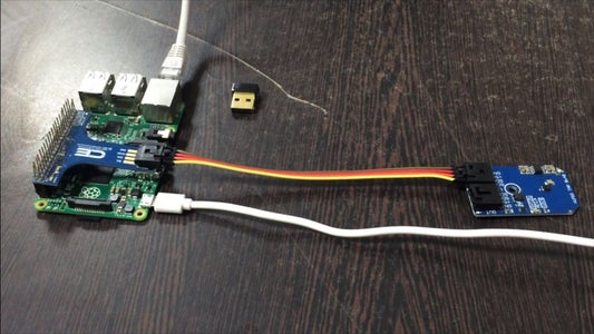

Step 2: Connection:
Take a I2C shield for raspberry pi and gently push it over the gpio pins of raspberry pi.

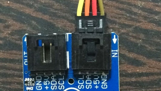

Then connect the one end of I2C cable to MAG3110 sensor and the other end to the I2C shield.
Also connect the Ethernet cable to the pi or you can use a WiFi module.
Connections are shown in the picture above.
