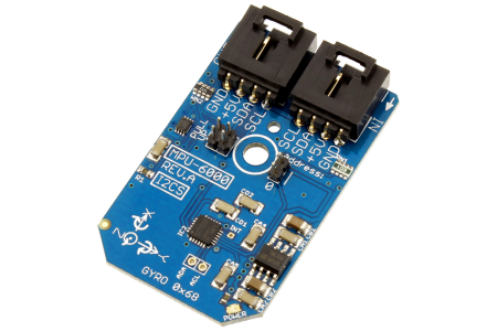

MPU-6000 is a 6-Axis Motion Tracking Sensor which has 3-Axis accelerometer and 3-Axis gyroscope embedded in it. This sensor is capable of efficient tracking of exact position and location of an object in the 3-dimensional plane. It can be employed in the systems which require position analysis to the highest precision. Here is the demonstration with a python code using Raspberry Pi.

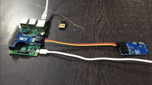

Take a I2C shield for raspberry pi and gently push it over the gpio pins of raspberry pi.

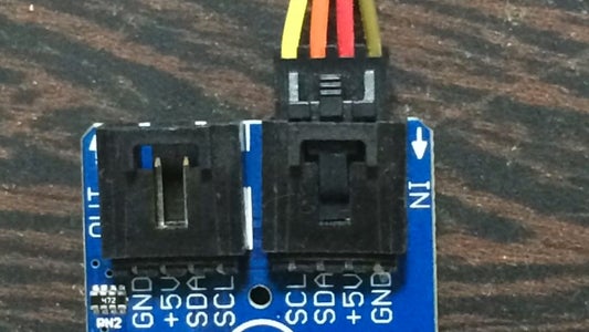

Then connect the one end of I2C cable to MPU-6000 sensor and the other end to the I2C shield.
Also connect the Ethernet cable to the pi or you can use a WiFi module.
Connections are shown in the picture above.
