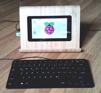

Introduction: Raspberry Pi Media Player and Work Station With an Integrated Speaker
A variety of frames for the Raspberry Pi touch screen are commercially available and published. Most of these solutions are silent, missing an active speaker. Adafruit has recently released a breakout with a I2S DAC & amplifier whichworks well with a RasPi and allows to directly attach a speaker.
So in the following I am describing how to build a Raspberry Pi media player and work station with a Raspberry Pi 2B, the official Raspberry Pi touch screen and an audio system, which consists just of the "Adafruit I2S 3W Class D Amplifier Breakout - MAX98357A" and a 4 Ohm/3 W/3" speaker. It has been tested to be working under Raspian and OpenELEC.
In analogy to a previous Instructable I was using an IKEA tablet stand as frame, this time the model RIMFORSA. It is made from thick bamboo plywood, it is looking good enough to be placed in a living room and allows to place the screen in a nearly upright position. In addition it allows to place the Raspberry Pi and a speaker, and/or other units, inside of the stand, resulting in a clean layout.It has a slot in the back plate, which is nice for the cables, but also would allow, and was intended for, hanging it on a wall.
The device can be either used as a small tablet-type computer (in combination with a keyboard) or as a media player using LibreELEC (OSMC not tested yet). If you are running Raspian Jessie, the keyboard comes quite handy, but is not required for LibreELEC.
The resulting sound is estonishingly good and the system is impressively loud. Using VLC to play MP3s I have to reduce the loudness to about 50-60 %. The I2S amplifier seems (currently) not to be recognized by the ALSA system in Raspian. If required, you may modify the amplifiers gain settings on hardware level (see last step).
A limitation of the MAX98357A is that it is that it has only one speaker output, so if you want to build a stereo system you may need two of them. By default it is mixing the right and left channels.
To turn the device into mobile device you can use a 2A USB power pack (tested).
You may alternatively attach the Pi directly to the back of the touch display. But I prefer to use a Pi case, as this allows better access to the Pi's ports and to build up some distance between the magnetic field of the speaker and the electronics. Especially for the WLAN stick I would fear interferences.

As a first step I marked a rectangular area of 16.8 x 10.2 cm at the center of the front side of the tablet stand, then I cut at the lines and cleaned the edges. As the bamboo plywood is very stable, no additional supporting structures are required. As next the holes to hold the Pi case, the breakout and the speaker were drilled at the indicated positions at the backside. Now a grid pattern was cut out where the speaker shall be placed (see image at Intro). I used a Dremel to cut and mill the bamboo plywood, an surprisingly tough material.
