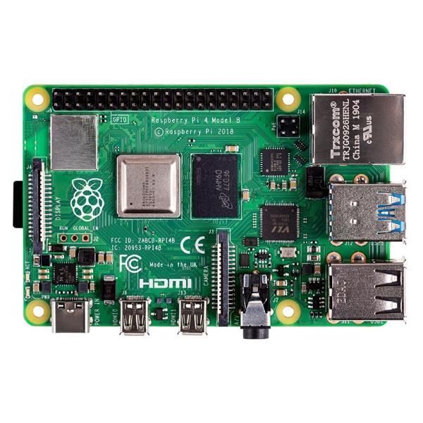

1x little cardboard box
1x raspberry pi model b+ or a+ https://www.canakit.com/raspberry-pi-3-model-a-pl...

Step 2: Attaching the PIR Sensor:
Connect the PIR sensor’s pin labelled VCC to the 5V pin on the Raspberry Pi. This provides power to the PIR sensor.Connect the one labelled GND to a ground pin on the Pi (also labelled GND). This completes the circuit.Connect the one labelled OUT to any numbered GPIO pin on the Pi. In this example, we have chosen GPIO 4. The OUT pin will output a voltage when the sensor detects motion. The voltage will then be received by the Raspberry Pi.
