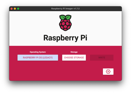

To install the software onto your Raspberry Pi, first flash the Legacy Buster Raspberry Pi OS to a formatted FAT-32 SD Card. If you are using the Raspberry Pi Imager App, you can turn on SSH and set your WIFI in the advanced setting menu.
