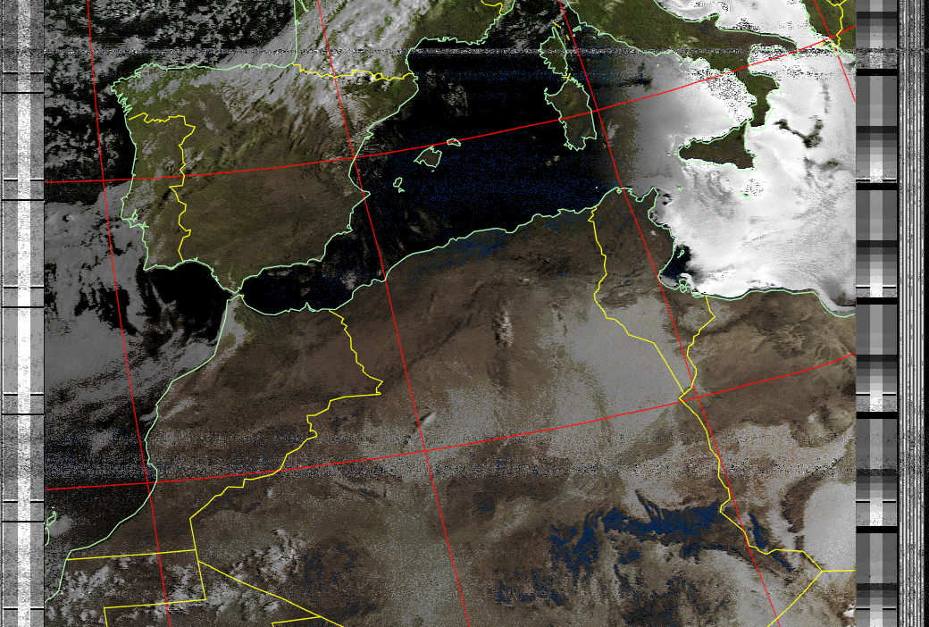

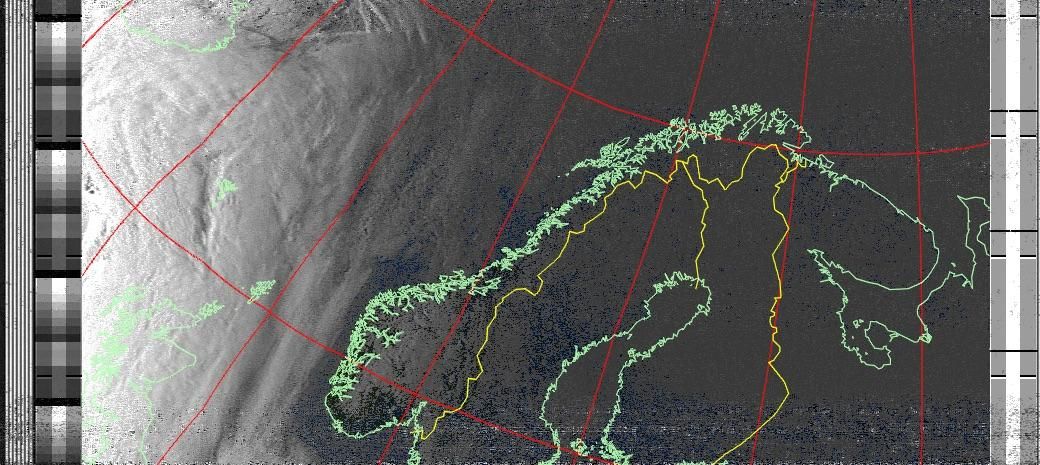

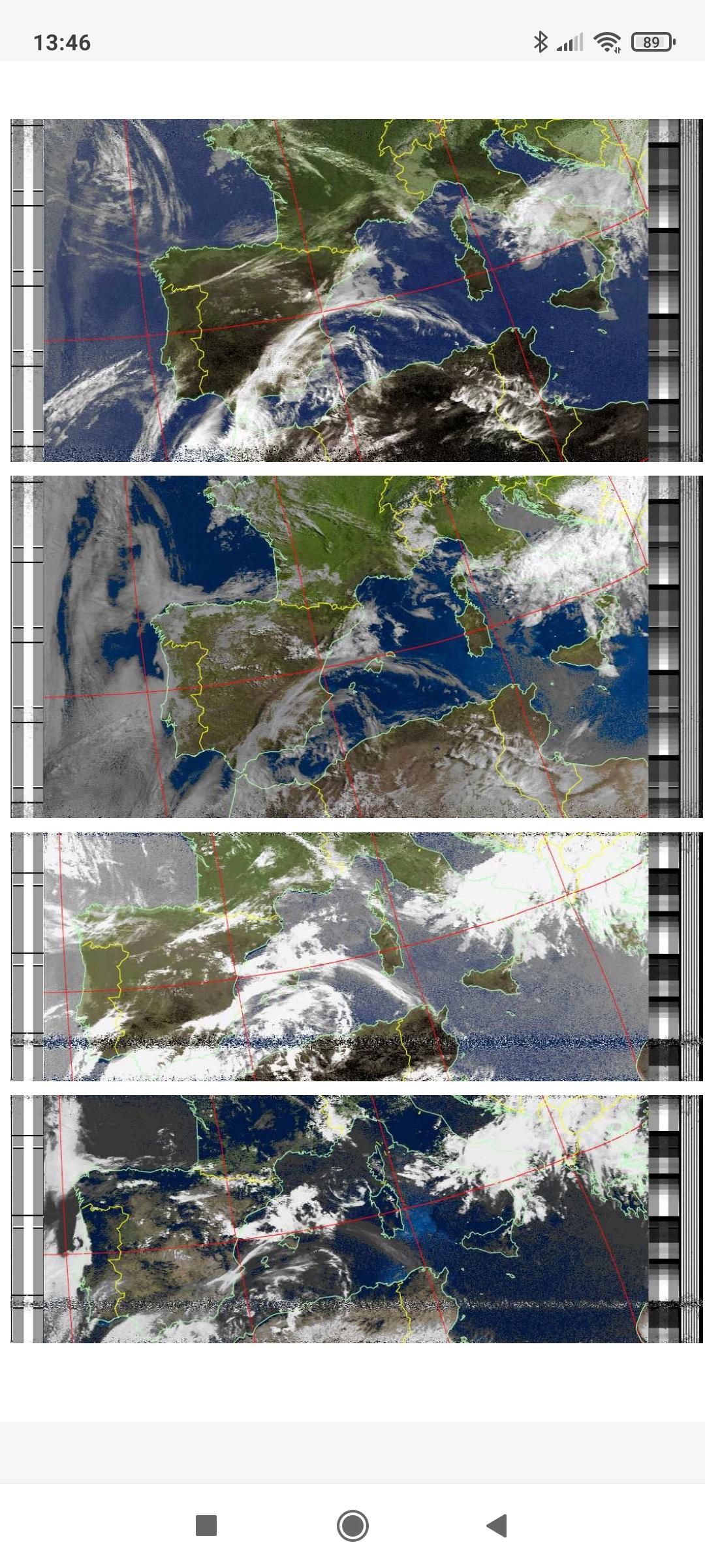

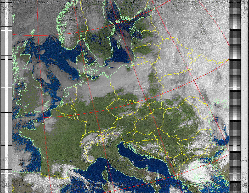

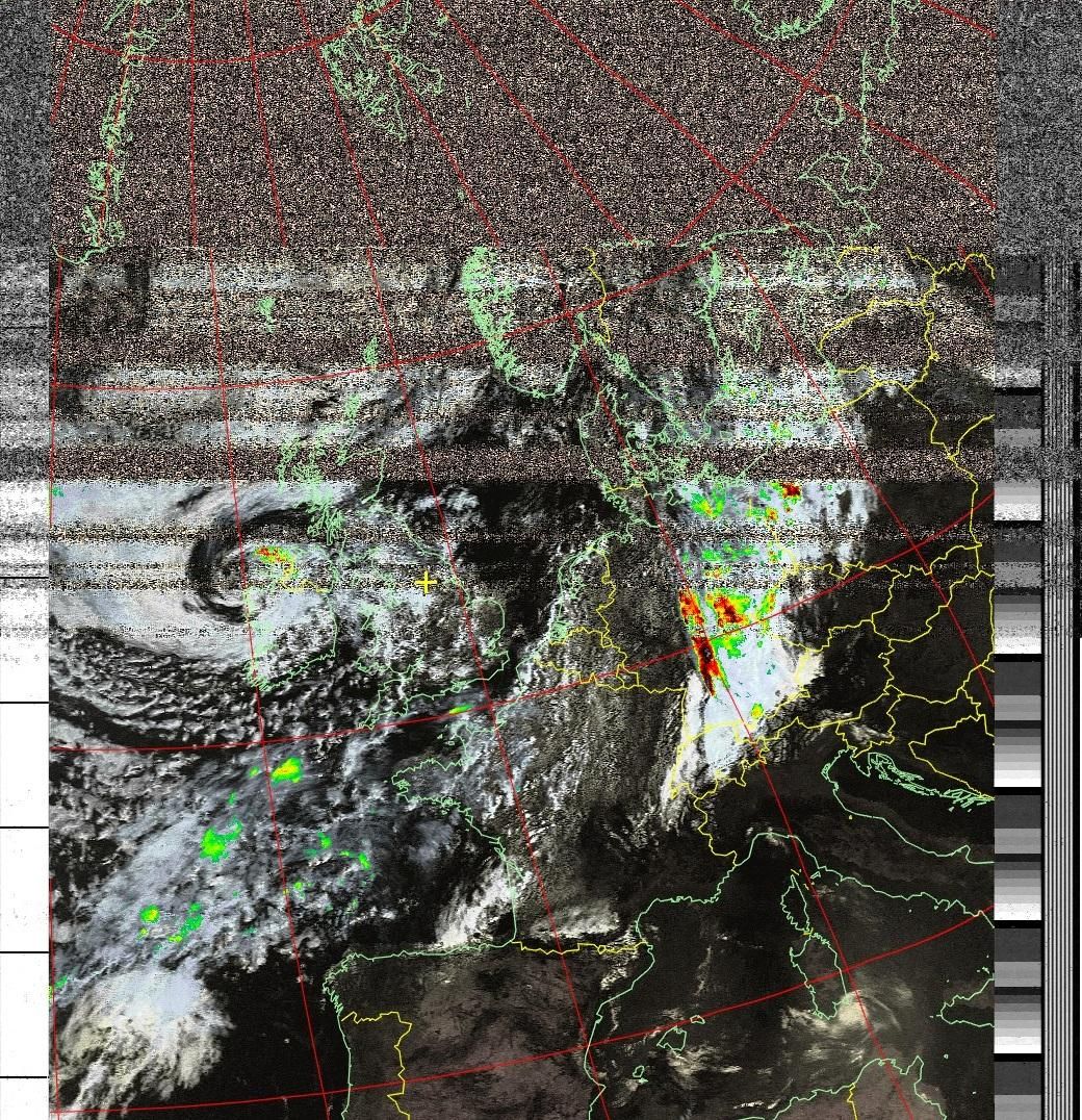

Check the ~/weather directory for your results. Each pass will generate three files:
NOAA1820170105-181147-map.png <-- Map overlay file NOAA1820170105-181147.png <-- The final image file NOAA1820170105-181147.wav <-- The raw audio file
The format of the file name is the satellite name, followed by the date (YYYYMMDD) and time (HHMMSS) of the start of the pass. There are several filters that wxtoimg can use when generating the image file. I've had different luck with different satellites and passes on each filter. Feel free to play around with wxtoimg on the original map and audio files and see what you come up with.
One thing to note, the receiver can only receive one satellite at a time. If two satellites are passing overhead at the same time, the first one to start recording will "win" and be recorded. The second recording will error out and stop.

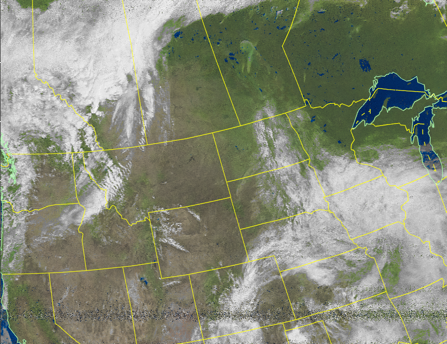

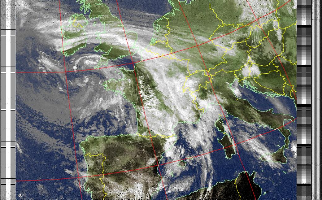

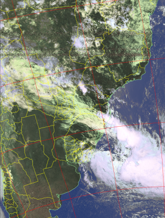

Step 6: Some of My Results
