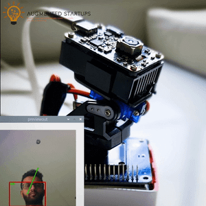

Today we are going to build a Pan Tilt tracking camera using a Raspberry Pi and OpenCV AI Kit.

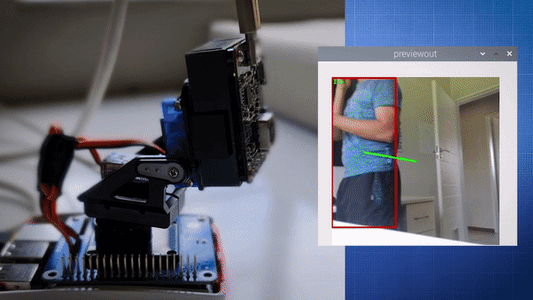

How it works, is that the smart camera uses object detection to adjust these servo motors so that the center of the image lines up with the object center. All this works at Real-time 30 Frames per second on a Raspberry Pi . So if you want to build your own then lets get straight into the tutorial.

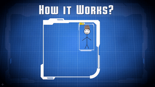

Let us first draw a window which represents the input image. Then we draw a second window which represents our detected object, we assume that we will only detect one object for simplicity of this tutorial.
This object is predicted using a Mobilenet SSD Object detection model that runs on the OpenCV AI Kit. So with the pre-trained model, you can detect people, bottles, dogs, chairs etc. There’s a total of 20 classes for you to test right away.
In our code, we calculate our object center in the x and y coordinates and find our exactly how far they are from the image center. If the object center cross a preset threshold window, it will trigger the servos to move either in the corresponding x or y direction. This process is repeated until the object center is within bounds of the image center.

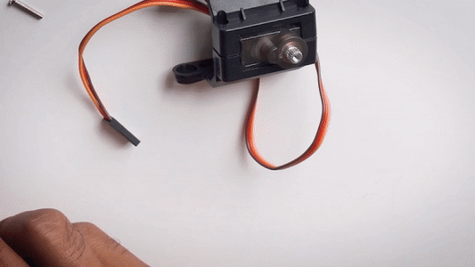

I opted for the Pan tilt hat from Waveshare, the kit was really easy to set up within 10 minutes. The only thing you will struggle with, is finding the right screws for the various parts. The connections can’t get simpler than this as you first connect the servo motors to the PCB and slip on the HAT to the raspberry Pi GPIO header.
To attach the OAK-1 to the kit, I had make some modifications to the head of the Pan tilt unit. Nothing serious, just need to remove these stubs over here. And with some double sided tape we firmly attached the OAK device to the pan tilt hat.

We just run the app, and we can test our code.
