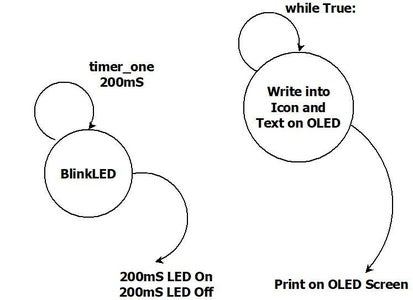

The timer_one is initialized and callbacks the “BlinkLED” functionality for toggling on board LED at 200mS duration. (frequency = 5)

# Initialize timer_one. Used for toggling the on board LED
timer_one = machine.Timer()
# Timer one initialization for on board blinking LED at 200mS interval
timer_one.init(freq=5, mode=machine.Timer.PERIODIC, callback=BlinkLED)

while True:
    # Clear the display
    display.fill(0)
    # Write text in two lines
    display.text("Raspberry Pico",10,8)
    display.text("OLED Display",10,22)
    display.show()
