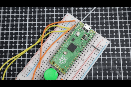

Step 2: Raspberry Pi Pico + Wiring
Let's first look at the Raspberry Pi Pico. The Pico has 26 are multipurpose GPIOs (general-purpose input/output) which for our application is perfect since we we will be connecting a few buttons and modules. The pinout of the Pico is given above.
For the 16x2 character LCD we will be using the I2C 0 protocol of the Pico.
The rest of the push, buttons along with the modules can be connected to any GPIO pins. I have included two schematic diagram to show all the necessary connections, the fritzing diagram and Easy EDA diagram. I decided to use the breadboard to make to process easier, and will on a later stage design a PCB with all the components on a single board.
One side of the buttons will be connected to the 3.3V power by the Pico's 3V3 output on pin 36. Using the 20 AWG wire it was stripped clean of insulation and then connected to one pin of the buttons where after the connections was made proper by soldering the wire to the pin to make good connection. The buzzer and Realtime clock module will also receive power from the 3.3V.
The LCD and WS2182b LEDs will receive power from Vsys pin 39 which will also be the input power from the 5V DC power supply.
After making all the necessary connections you will first need to program the Pico before closing the case.

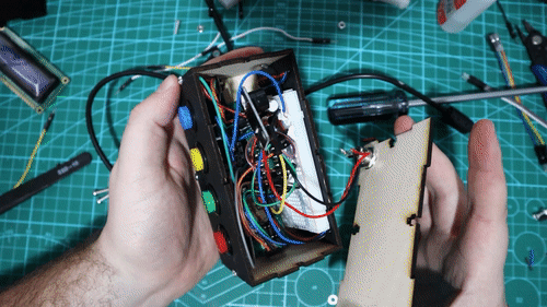

Step 5: Assemble Alarm Clock
You now have a working alarm clock with all the code running. The final step is to assemble the clock and fit everything in the enclosure. Now, this might take some time, and you need to make sure that the cables are the correct length and are making a proper connection on the breadboard. In the future, creating a PCB version will eliminate any of the problems.
The case is easy to assemble using the bolts and nuts in the T-slot joints.
