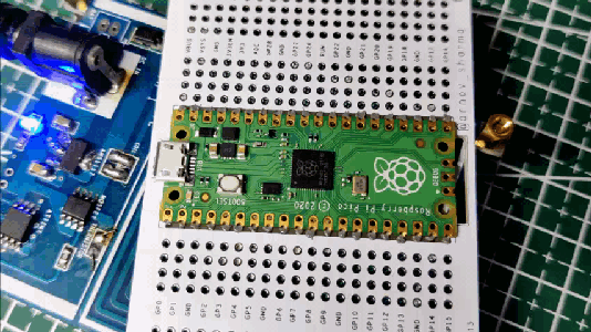

So here's a fun little project that tackles a major issue with the Raspberry Pi Pico Microcontroller.
The Raspberry Pi Pico's pinout information is located on the bottom side of the board, which makes prototyping difficult. When we mount the device on a breadboard, we have to utilize a reference guide to determine which pins are whose, which is a messy procedure.
All the pinout details are on the top side of the expansion board I made. To showcase the Pico's HID capabilities, we connect it to an extension board and utilize it to build a simple mouse.
This Expansion board have extra 4 pins for each GPIO pins and have few extra pins on both sides which are not connected to anything, these are for placement of XYZ components for making quick prototypes.

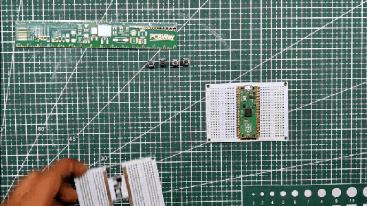

Following are the materials used in this built-
- RPi Pico
- Custom PCB (which was provided by PCBWAY)
- Push Buttons
- Connection wires
- PCB Standoffs

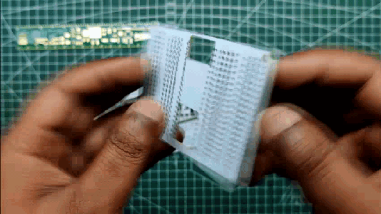

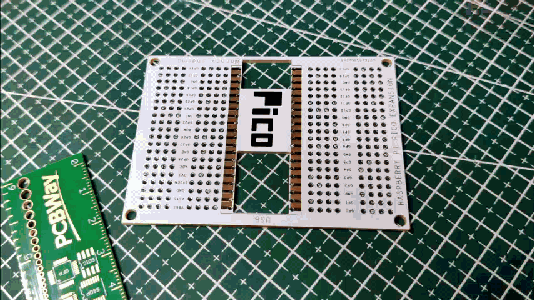

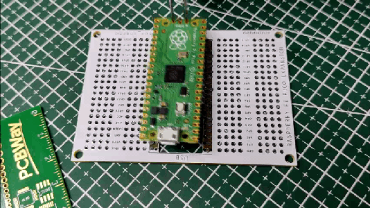

Step 1: Expansion Board Design
The expansion board was designed by keeping a few things in mind which were the extra GPIO Pins for each Pin and a few extra con pins for adding stuff, another thing was that GPIO Number Details on the Topside were nice and clear.
The project's schematic was incredibly straightforward; I simply duplicated a Pico design in my CAD software and connected a CON4 pin to each of the Pico's GPIO pins.
I created a PCB design from the PCB schematic and included a hybrid pad for Pico's placement that contains a hole for header pins and a pad for mounting Pico as an SMD module on the PCB.

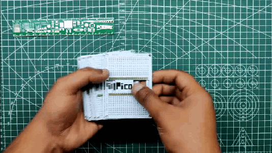

Step 2: Getting PCBs From PCBWAY
I sent the finished PCB to PCBWAY for samples and receive them after a week.
White Soldermask with Black Silkscreen was chosen for the order since it generally makes PCBs seem beautiful.
In terms of overall quality, it was outstanding. Each of the 10 boards I bought was flawless.
I've been using their service for a while, and I must say that the PCBs I received was excellent, just as I had hoped.

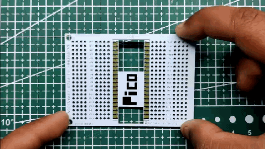

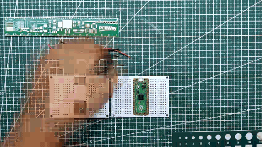

Step 3: Board Assembly
- Board Assembly Process begins by first adding solder paste to each component pad one by one.
- Next, using a tweezer, we pick RPi Pico and place it in the designated position, we do have to align the board according to the pads.

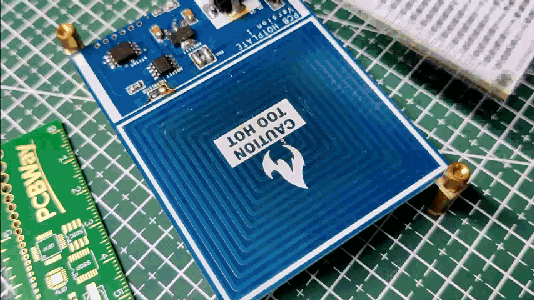

- Following that, we carefully lifted the entire circuit board and set it down on the Mini SMT Hotplate, which heats the PCB from below up to the solder paste melting temperature. As soon as the PCB reaches that temperature, the solder paste melts, and all the components are connected to their pads.
Due to the board's slightly larger size compared to the PCB Hotplate's pads, I had to reflow the board twice by shifting the PCB.

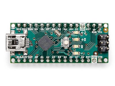

The Atmega382PU or AU used in general-purpose boards like the Arduino Nano or UNO is fantastic for prototyping for any project, but it does not support HID, so we cannot build a game console project with one of these boards. (There is another, more complicated way to use an Uno or Nano as a game controller.)
We use the Atmega32U-powered Arduino Micro or Leonardo for projects involving HID.

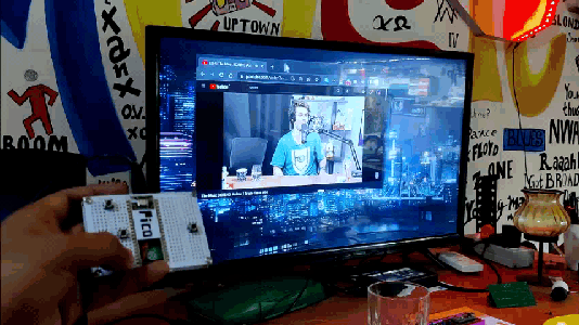

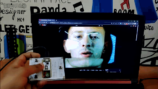

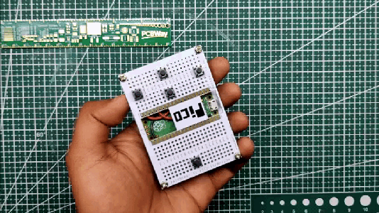

Step 6: Mouse Assembly
- In order to build an HID mouse, we first take another expansion PCB, add push buttons to it, and solder the buttons into position.
- We attach one pin of each Push button to GND and then attach other pins to GPIO0, GPIO1, GPIO2, GPIO3, and GPIO4. (see the attached Wiring Diagram)
- By using Four PCB standoffs, we attach two PCBs together using four Mounting holes.

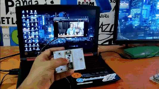

Step 8: Result
Here's the result of this build: a functional HID mouse with one button for selection and four directional buttons for movement.
This configuration cannot take the place of a standard mouse. This is merely a concept to demonstrate the RP2040's capabilities and how it can take the place of Arduino-powered HID-capable microcontrollers.
