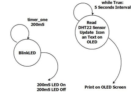

RPi Pico reads the temperature and humidity at 2 second interval and displays on OLED.

The timer_one is initialized and callbacks the “BlinkLED” functionality for toggling on board LED at 200mS duration. (frequency = 5)

The program initializes the OLED and DHT22 devices.
The Program reads the DHT22 sensor at 5 Sec interval and updates the OLED screen.
Temperature / Humidity Icon is populated and 2 rows of temperature / humidity sensor reading are displays on OLED screen.

while True:
    T, H = dht22.read()
    display.fill(0)
    # Write the Temperature and Humidity ICON
    fb = framebuf.FrameBuffer(humid, 32, 32, framebuf.MONO_HLSB)
    display.blit(fb, 0, 0)
    #Write Humidity value. Convert the humidity into two decimal places.
    display.text(str('H: ' +"{:0.2f}".format(H)+ "  %",2),40,5)
    #display.text("H: " + str(H) + " %",40,5)
    #Write Temperature value. Convert the temperature into two decimal places.
    display.text(str('T: ' +"{:0.2f}".format(T)+ "  C",2),40,19)
    #display.text("T: " + str(T) + "  C",40,19)
    #Draw the degree symbol. Its 4x4 pixel squire.
    display.fill_rect(113, 18, 4,4, 1)
    #Show display
    display.show()
    # Wait for Five seconds. Then proceed to collect next sensor reading.
    time.sleep_ms(5000)
