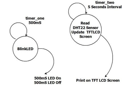

RPi Pico reads the temperature and humidity at 5 second interval and displays on HVGA LCD.

The timer_one is initialized and callbacks the “BlinkLED” functionality for toggling on board LED at 500mS duration. (frequency = 1)
The HVGA LCD class provides basic firmware functionalities like Init, ResetDevice, WriteDevice, WriteDataToDevice, WriteBlock and FillRectangle, WriteString etc.
The python program, initializes ILI9488 HVGA LCD with SPI interface, and the DHT22 sensor.
The python program reads the temperature and humidity values at 5 seconds interval.
The temperature is in Celsius format, which is converted into Fahrenheit, Kelvin and Rankine format by the software. Converted formats of temperature and humidity are displayed on the HVGA LCD, at 5 Sec interval.

#Initialize timer_one. Used for toggling the on board LED
timer_one = machine.Timer()
#Timer one initialization for on board blinking LED at 500mS interval
timer_one.init(freq=2, mode=machine.Timer.PERIODIC, callback=BlinkLED)
# Initialize timer_two. Used for reading DHT22.
timer_two = machine.Timer()
# Timer two initialization for reading sensor at 5 Seconds interval
timer_two.init(freq=0.2, mode=machine.Timer.PERIODIC, callback=ReadDHT22Sensor)
ReadDHT22Sensor(timer_two)
