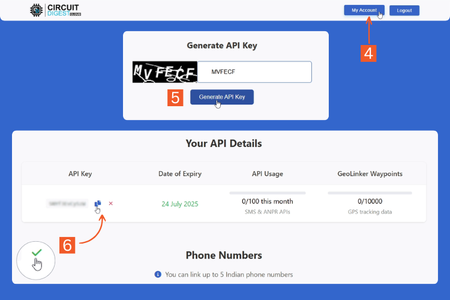

Step 2: Setting Up GeoLinker Cloud
We’ll be using CircuitDigest’s GeoLinker API to send and visualize GPS data.
  1. First, sign up on circuitdigest.cloud.
  2. Generate an API Key from your dashboard.
  3. That’s the magic password your Pico uses to upload data.
API limits:
  1. Up to 10,000 GPS points per key.
  2. SMS/ANPR stuff capped at 100 requests per key.
If you burn through that, just generate a new key.

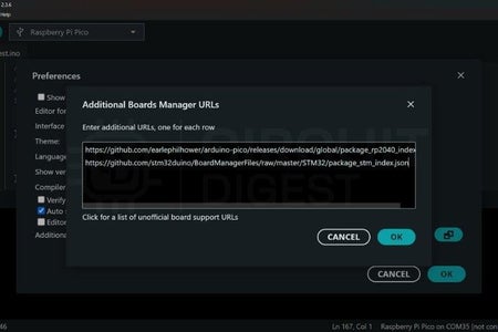

  1. Open Arduino IDE → File > Preferences.
  2. Add this to “Additional Board Manager URLs”:
https://github.com/earlephilhower/arduinopico/releases/download/global/package_rp2040_index.json

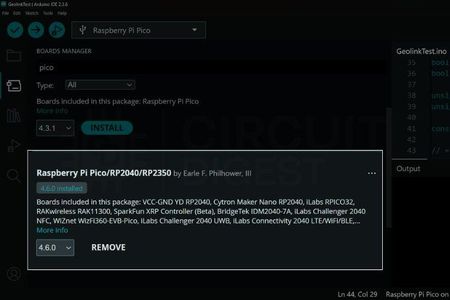

  1. Go to Tools > Board > Boards Manager, search “RP2040,” and install “Raspberry Pi Pico / RP2040 by Earle Philhower.”

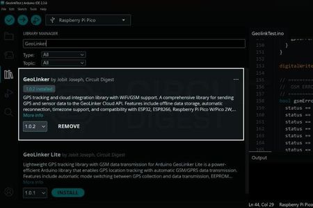

  2. Install the GeoLinker library from Library Manager (search “GeoLinker”).
  3. You’ll now see example sketches under File > Examples > GeoLinker.

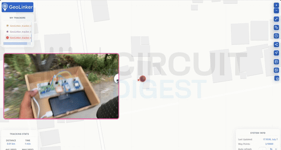

  4. Once it locks onto satellites, it’ll start sending coordinates to the cloud.
Now log in to CircuitDigest Cloud → check your GeoLinker dashboard → and you’ll see your tracker plotting points in real time.

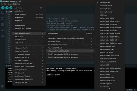

GeoLinker library missing? Restart Arduino IDE after installation and make sure you selected Raspberry Pi Pico under Tools > Board.
